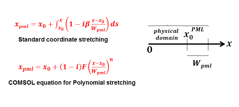

The coordinate stretching COMSOL uses seems a bit different from the standard ones I have seen in the literature (please see the file attached). It looks like COMSOL scales both real and imaginary part. However, I have no idea how the rational stretching works (the equation is more complicated) ! The F (comsol) and beta (standard) work as the absorbing coefficient.

I'm glad you are learning new things and to know that I'm being of help to you. But so far you have not tell me anything about your results. Have you tried with a thin PML? what are the results? Do try a convergence study and tell me what are your results.
I think there are not an easy way to calculate reflections of the PML using Comsol. Berenger (the father of PMLs) do have a code for that using FDTD. But I have never used it and it is more oriented to Electromagnetic Waves, which is not your case.

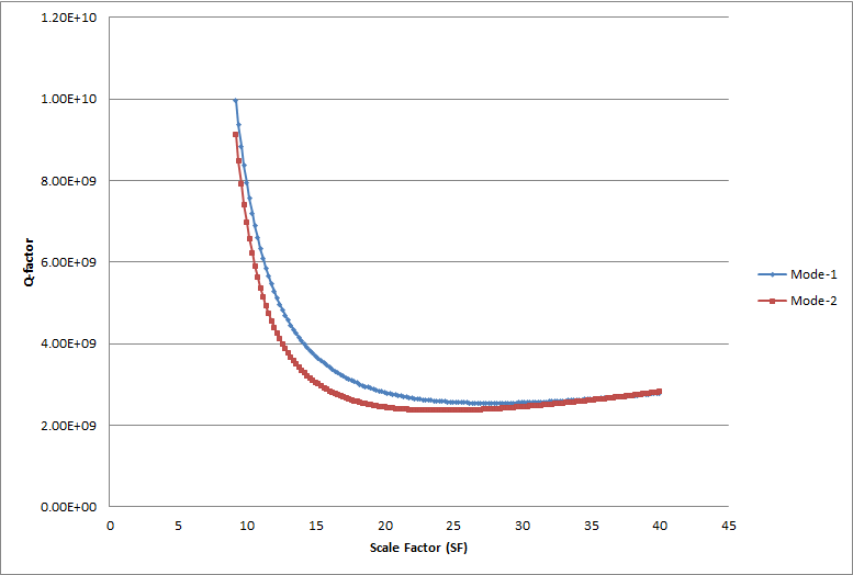

I have attached a file showing a convergence curve. I have used rational stretching and varied the scale factor gradually. You can see that as SF increases the Q-factor tends to converge. My PML was of reasonable width compared to the geometry. Please have a look at it.Thanks.
Posted: 1 decade ago 2014/03/31 14:35 GMT-4
Ruzbeh,
I see a reasonable convergence trend. So what is your main question?
cheers,
Felipe BM
Ruzbeh, I see a reasonable convergence trend. So what is your main question? cheers, Felipe BM

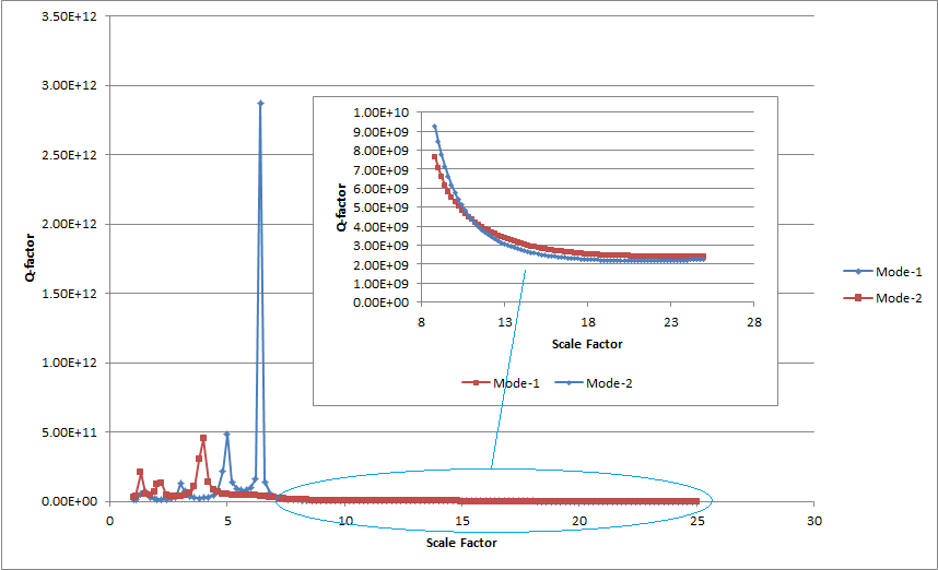

Thanks for you reply. I have attached a graph of my Q-factor vs scale factor. Generally the two modes are expected to have similar Q values. But there's a difference between two Q values initially. As SF is increased further two values become similar BUT you could see the divergence of the two curves. I hope you could give some suggestion on that.
Also, how accurate are cylindrical/spherical pmls compared to rectangular ones?

Posted: 1 decade ago 2014/04/08 15:08 GMT-4
Ruzbeh,
What you show in your graph is, I suppose, the expected behavior for a PML:
If you put a low scaling factor, it is similar to put a low-absorption boundary condition. Then the outgoing waves will go in and out of your PML causing spurious reflections.
If you put a high scaling factor, it is similar to put a very-absorptive boundary condition (high conductivity) and it will behave as a metal, which will translate also in spurious reflections.
PML success, as in live, depends on having the exact amount of each ingredient... that is why PMLs are perfect :)
There are lots of papers about how to tune the PML parameters. I dont know any of them applied to the area of MEMs or Structural Mechanics, but I'm sure a simple search will lead you in that way.
If I were you, wouldn't waste more time and start using a scaling factor between 35 and 40.
good luck with your experiment,
Felipe BM

Ruzbeh,
there are two main PML formalisms: (1) the stretching coordinate and (2) the uniaxial material (UPML).
both are equivalent, I prefer the second one (UPML) because it gives a physical insight of what happens inside the PML.
When you increase the complex part of your PML, is like increasing the conductivity of the material of the domain where the PML lies. Materials with high conductivity are conductors, and they act as reflectors when an incident (electromagnetic) wave crosses the interface. That is why most conductors are brilliant .
I suggest you read Dr. Johnson's notes on PMLs:
www-math.mit.edu/~stevenj/18.369/pml.pdf‎
cheers,
Felipe BM
Ruzbeh, there are two main PML formalisms: (1) the stretching coordinate and (2) the uniaxial material (UPML). both are equivalent, I prefer the second one (UPML) because it gives a physical insight of what happens inside the PML. When you increase the complex part of your PML, is like increasing the conductivity of the material of the domain where the PML lies. Materials with high conductivity are conductors, and they act as reflectors when an incident (electromagnetic) wave crosses the interface. That is why most conductors are brilliant . I suggest you read Dr. Johnson's notes on PMLs: www-math.mit.edu/~stevenj/18.369/pml.pdf‎ cheers, Felipe BM
