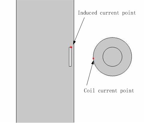

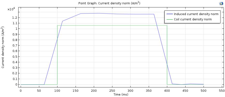

Posted: 9 years ago 2016/09/30 9:44 JST
Hanna,
if you just need a harmonic excitation you should consider using a frequency domain or frequency transient study.
Cheers
Edgar
Edgar J. Kaiser
emPhys Physical Technology
www.emphys.com
Dear Edgar,
I am also confused that when I set the "Coil current" as a rectangle function (starting at 100 ms and ending at 400 ms, ), the induced current density norm rises ahead of the "Coil current" density norm.
Why does this happen? From my point of view, the induced current density norm should lag behind the "Coil current" density norm.
Could you help me solve this problem?
Sincerely,
Ken
