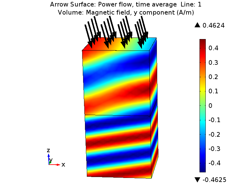

Another question I had is that currently the Fresnel model has the has the wave vectors coming in from the side of the material.
To study and model EM waves that come in from bottom to top instead, would you just have to change the Electric field vector from depending on the y-component to depending on the z-component?
The incident wave is coming in from the top surface. You can see this by plotting Poynting vector which gives the direction of the power flow and, hence, the direction of the wave propagation, as shown in the attached image.
The basic idea is that whatever direction incident wave is coming from, you decompose the wave-vector to the normal to the interface component and tangential components to the interface. Then, use normal component of the wave-vector to set-up port boundary condition and use corresponding tangential component for Floquet boundary condition.
