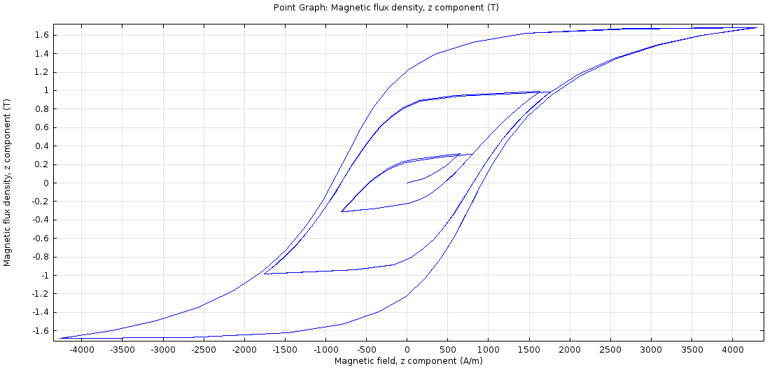

I just loaded "hysterese_example.mph" into versions 4.3.2.189 and 4.4.0.195 and it
works for me right away. See picture. I'am running Comsol on Linux.

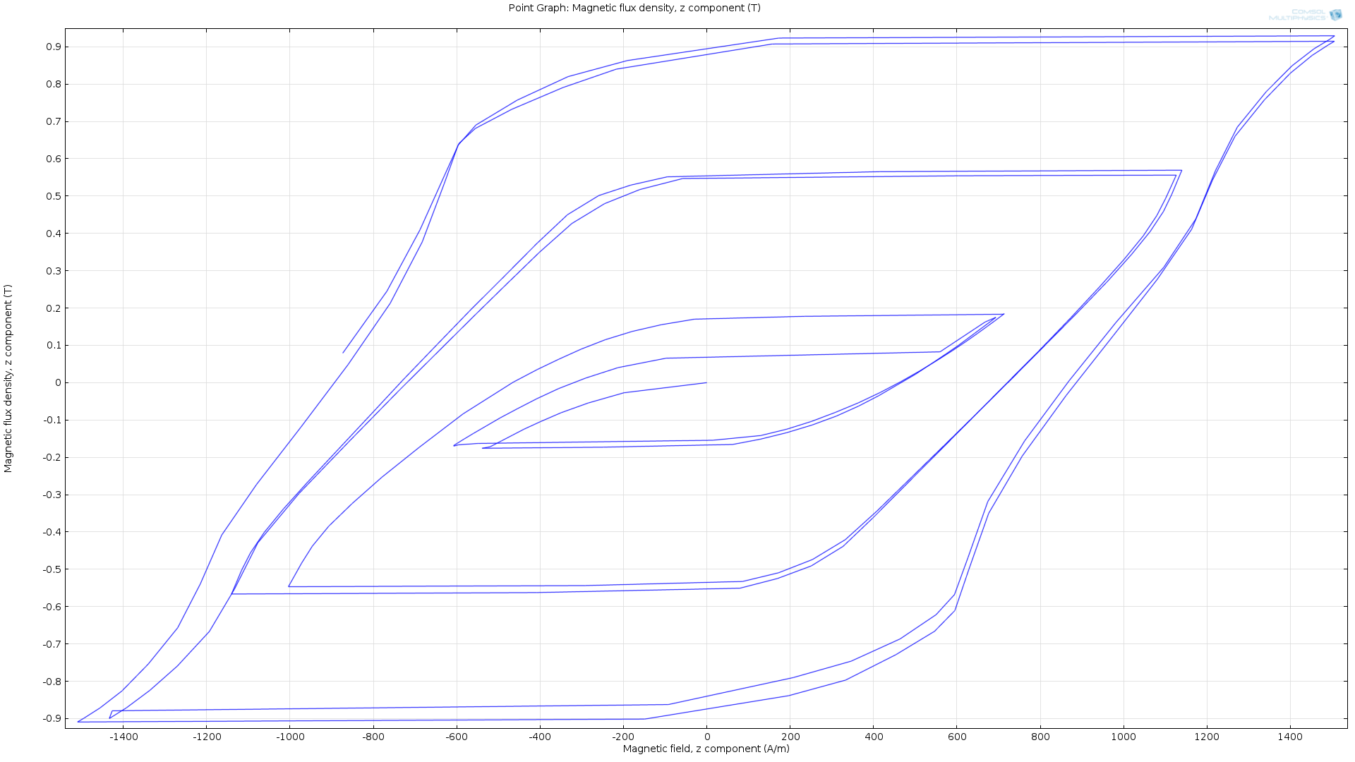

Thank you so much for your help!
It's still not perfect, but It basically works now :)
I attached the Hysteresis Curve I produced :)
Regards
Rook
