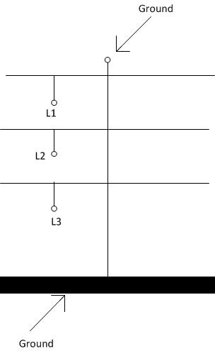

                                                    Dejan,
you can apply phase shift using complex notation. Ground or electric potential BC is available under the Magnetic Insulation node.
Cheers
Edgar

                                                    Hello Edgar
Thank you for your quick response.
Is it possible in Comsol (frequency domain) at least in the post process to produce a sinusoidal signal?
Maybe with the 1D plot (Global).
Best regards
Dejan

Yes, you can use the phase as x-axis parameter.

                                                    Hi Edger,
thanks again for your help, but something I'm doing wrong.
Could you, if you have time, look at my model, I cannot produce sinusoidal curve?
And I do not know why?
Best regards

                                                    The parameter J3 is a constant per your definition. You have to use a field parameter, e.g. a point plot of a magnetic flux density component or a current density component. Keep in mind that only vector components are phase dependent, the normalized quantities are not (in COMSOL). You can add points into your geometry or use probe plots.
