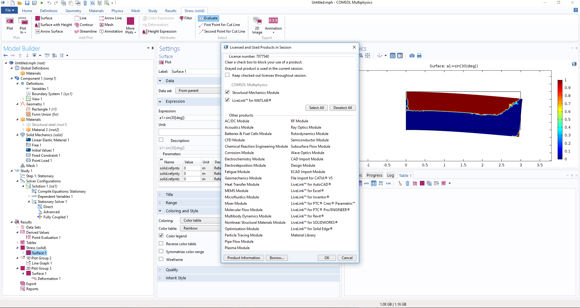

Posted: 8 years ago 2017/05/19 13:03 GMT-4
Thanks for your message.
I believe I "have" the module, please see the photo attached.
Jeff Thanks for your message. I believe I "have" the module, please see the photo attached.
Jeff Hiller COMSOL Employee
Posted: 8 years ago 2017/05/19 13:47 GMT-4
Hello Farough,
You are right. What I forgot is that for the Plasticity node to appear you need not only the Structural Mechanics Module but also either one of the Geomechanics Module or Nonlinear Structural Materials Module (See www.comsol.com/products/specifications/structural-mechanics/).
Sorry for the confusion.
Hello Farough, You are right. What I forgot is that for the Plasticity node to appear you need not only the Structural Mechanics Module but also either one of the Geomechanics Module or Nonlinear Structural Materials Module (See https://www.comsol.com/products/specifications/structural-mechanics/). Sorry for the confusion. Best, Jeff
