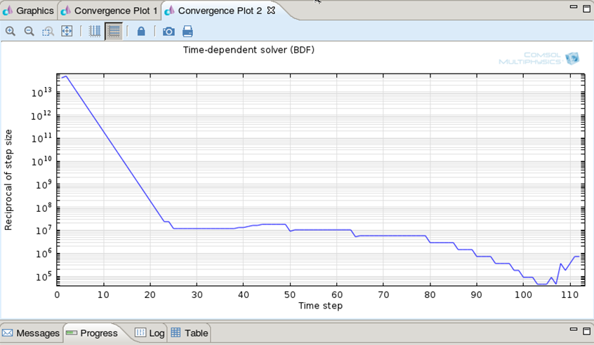

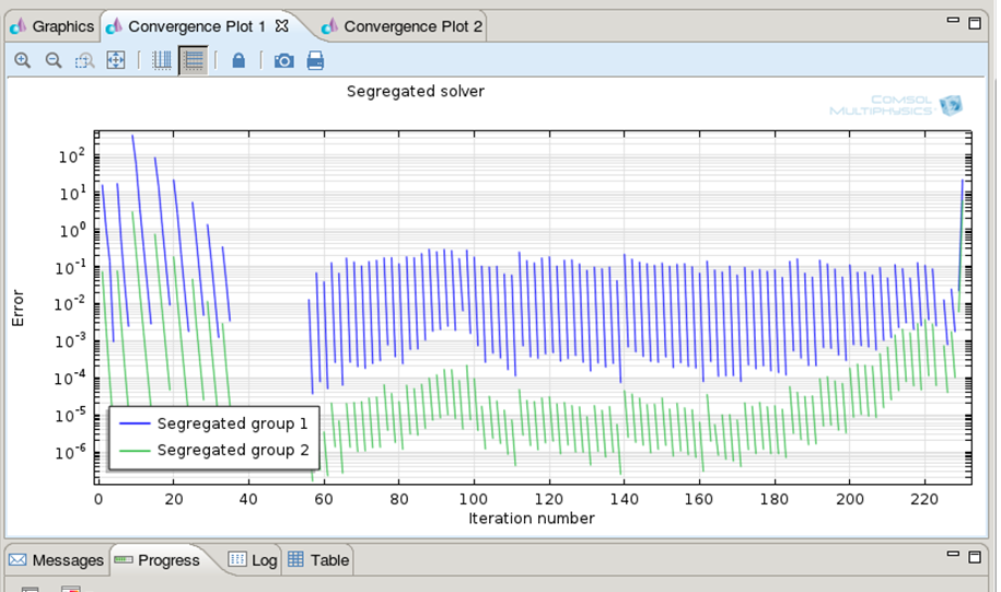

The calculation takes very long and it stops at 4 %. Until this point the convergence behaviour looks very good but then it changes, see attached screenshots, and I can't figure out why. In my opinion its not a physical problem because at the time, when the calculation stops the maximum fluid pressure is about 20 bar, the minimum filmthickness at about 20µm whereby the stresses are quite low. I think the problem must be the way the solvers work. I dont have enough experience to cope with this kind of problem. Thats why I would like to ask help from u.

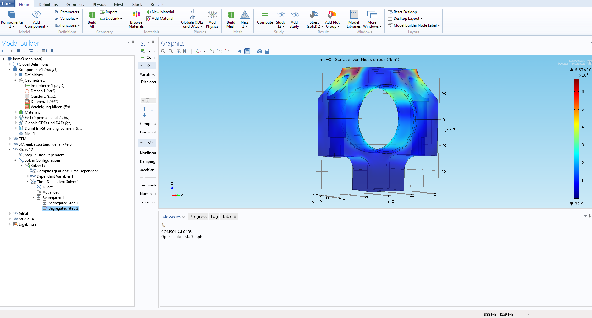

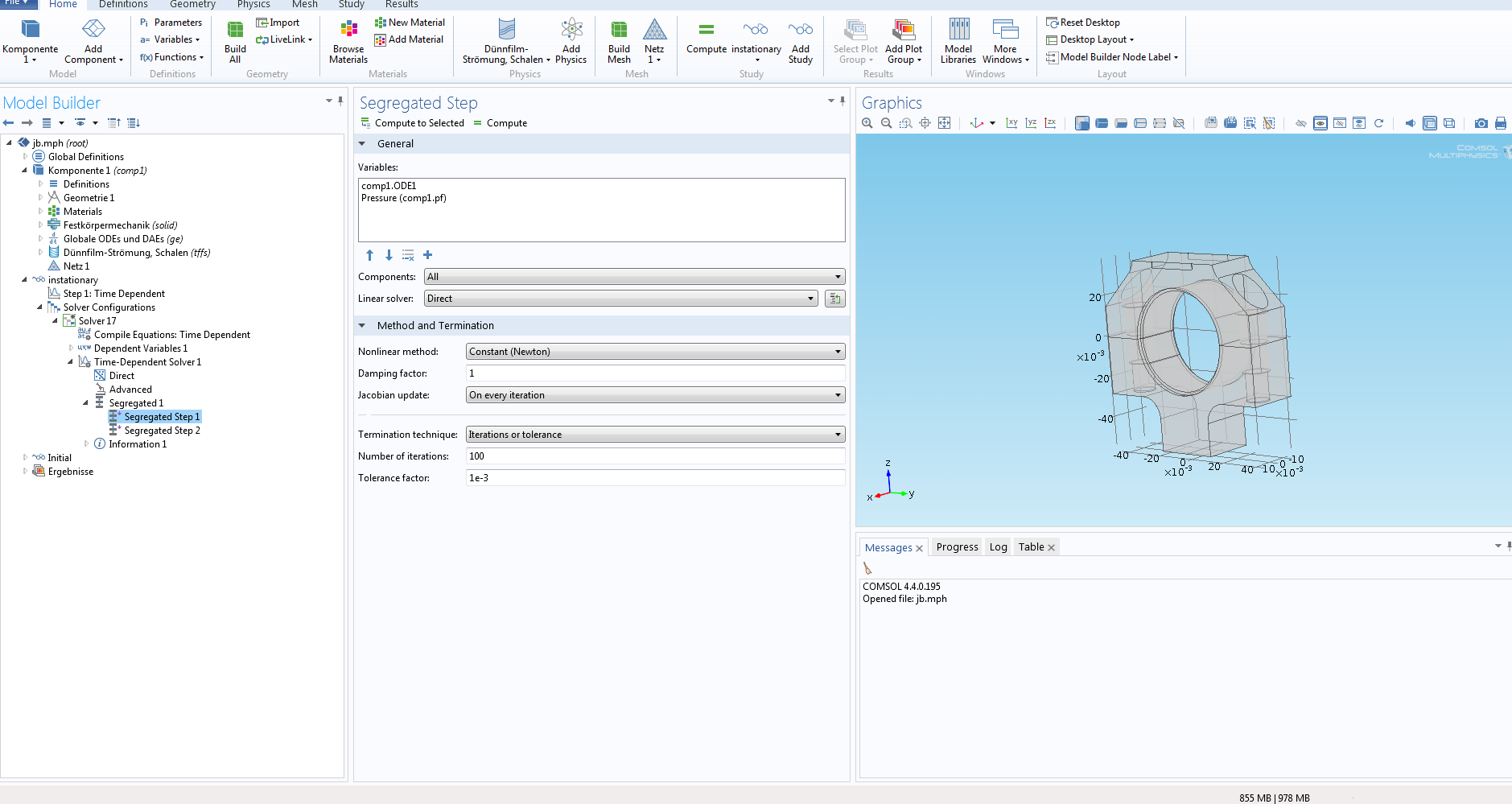

I add some screenshots of the model so u can imagine how it looks like and a screenshots of one of the two solvers. (both have the same specification)
