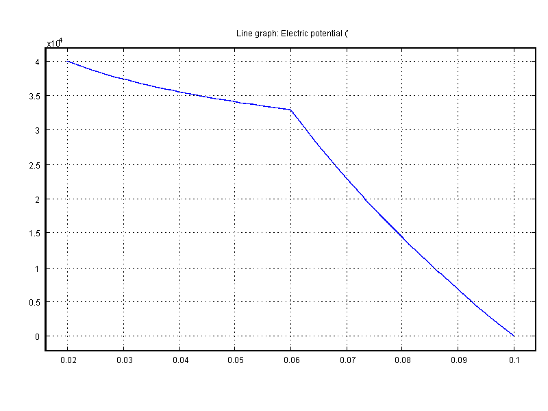

Using this model, or using its counterpoint axi-symmetric 2D model, I keep getting this result:
-- Attached file : Image_comsol
I've tried using Union mode and Assembly mode for creating the geometry, but alas, it's still the same. I've attached all 3 models which basically all give the same result, different than the one I should be getting analytically.

actually I would expect the COMSOL result and not your analytical calculation. The potential is obviously continuous at the internal boundary, but with a kink,which is to be expected, because the conductivity changes. And thus the field is discontinuous.
Cheers
Edgar

Posted: 1 decade ago 2014/06/13 18:31 JST
But the conductivity is different in the two domains, so it is dependent on a spatial coordinate. A simple analogy would be a serial circuit of 2 resistors. Say you have 1 Ohm and 9 Ohm in series and 1V attached to the terminals. This will result in 0.1 V and 0.9 V voltage drop.
Or maybe I misunderstand you setup completely,
Cheers
Edgar

Jeff Hiller COMSOL Employee
Posted: 1 decade ago 2014/06/13 21:31 JST
Your equation iv should read
iv) J_domain1 (r = r_med ) = J_domain2 ( r = r_med)
not
iv) E_domain1 (r = r_med ) = E_domain2 ( r = r_med)
Your equation iv should read iv) J_domain1 (r = r_med ) = J_domain2 ( r = r_med) not iv) E_domain1 (r = r_med ) = E_domain2 ( r = r_med) Jeff
