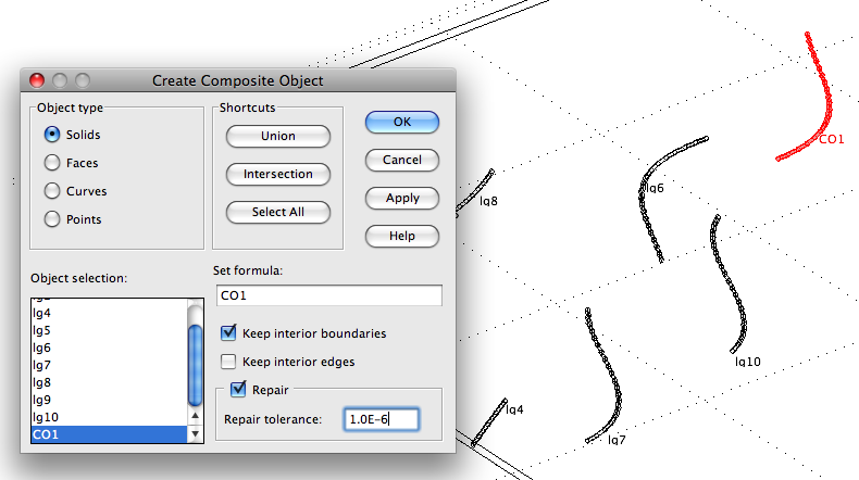

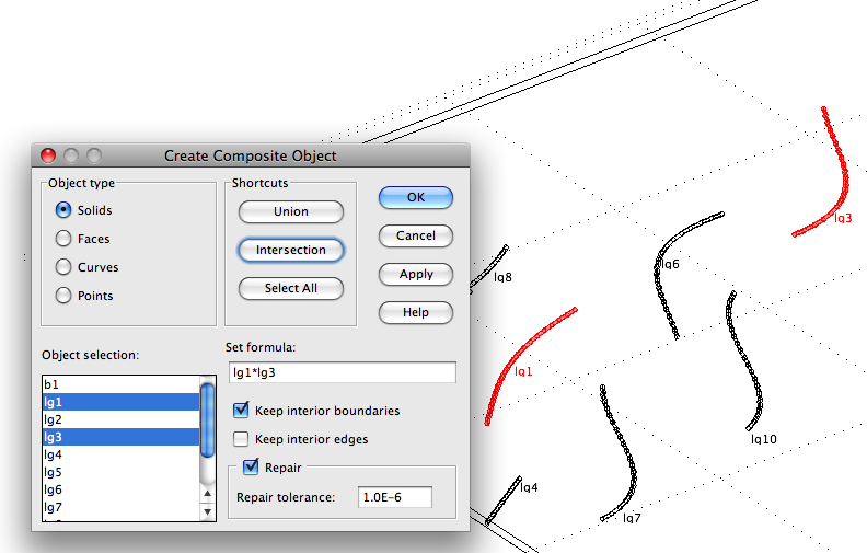

I attached two images to show how that happened.
celina
Hi Ivar, Thank you for your reply. I just double checked, and I am now pretty sure that I did click the 'intersection', not 'difference'. Even I do the intersection operation by hit the (+/-*) as you suggested, the same thing happens. I attached two images to show how that happened. celina
