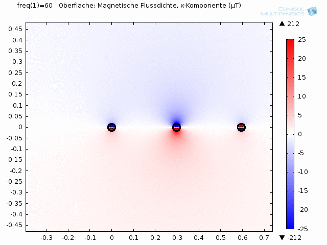

Posted: 1 decade ago 2014/06/17 5:14 GMT-4
Dear Akim,
i have solved yout 2d model.
freq = 60Hz
R L1 (mΩ) = 5.73224
R L2 (mΩ) = 5.72243
R L3 (mΩ) = 5.69881
L L1 (nH) = 441.67833
L L2 (nH) = 362.688
L L3 (nH) = 334.39856
Z L1 (mΩ) = 5.73224+0.16651i
Z L2 (mΩ) = 5.72243+0.13673i
Z L3 (mΩ) = 5.69881+0.12607i
hope it help you. The 3d Simulation take a while. Becaus the 3 D Model is not finished and I didnt found any port or coil configuration.
regards Viktor
