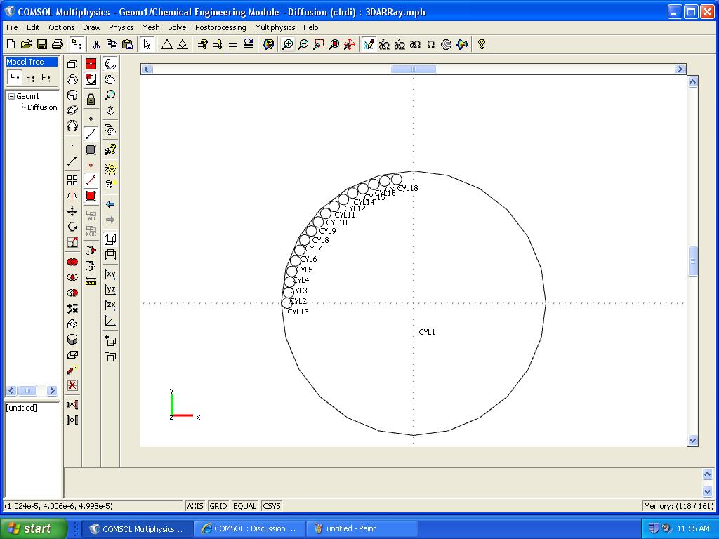

I want to draw a circular array inside a big circle. I did this with fairly big circles manually. But it is very difficult to do with small circles. Do you have an any idea of doing this automatically with comsol.
I have attached the drawing I want to do.

en.wikipedia.org/wiki/Packing_problem#Circles_in_circle
is this this that you want to do?
filling a big circle with small circle is a complex and old problem
there is no easy way to do it !
sorry

Dear Jean,
Thank you for your reply and the explanation. I understood the problem's complexity.

Hey,
Just go to Transform - > Rotate. Set up an input object and specify a rotation angle with the range and a step. Hit build selected.
