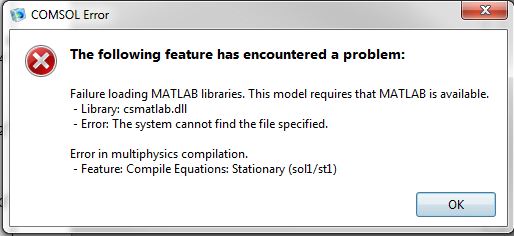

I am trying to model a smart material called Magnetorheological Elastomers. It can change it's stiffness when a magnetic field is present. To do this, I would like to use a MATLAB function that can calculate the shear modulus based on the field present.
However, I keep running to the issue that the MATLAB directory is not setup correctly... I have gone into MATLAB and set the path directly to where all of the files are located and it still cannot run.
I am using MATLAB 2013a and COMSOL 4.4. I have the read the User Guide for MATLAB LiveLink and I don't understand how to set up the path through the MATLAB command.

it might be the case that you need to set the path to the shared libraries. On a Linux machine this looks like this
export LD_LIBRARY_PATH=$LD_LIBRARY_PATH:/usr/local/MATLAB/R2014a/bin/glnxa64
On Windows this should be similar.
Hope that helps.

Thanks for replying. I agree, I think the issue is that the path between the two programs is not set correctly. I am able to open COMSOL with MATLAB and run different kinds of models, except those with functions embedded in the COMSOL model.
Where would I write that line in order for the two programs to be on the same path?

this might be also solved by setting an environmment variable. On Linux machines there is the following command:
export COMSOL_MATLAB_PATH=path_to_my_external_MATLAB_functions
with path_to_my_external_MATLAB_functions being the path to your MATLAB code. Then Comsol server knows where to look for external MATLAX functions. On Windows machine this can by done somewhere in the system settings.
Another option is to use the Set Path in the MATLAB options. Adding only to the MATLAB path via addpath() will not work because Comsol uses a 'clean' new MATLAB instance for external functions.
Chris
