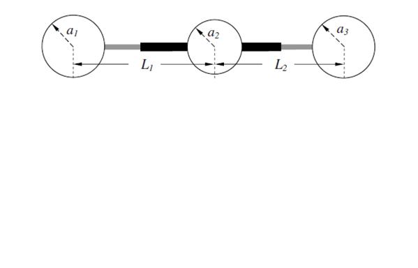

I'm new to comsol and I'm trying to model the flow of three spheres connected by two movable rods in a stationery fluid. There is relative motion between the spheres as the rods move to and fro.
I'm trying to analyze the motion of this sphere-rod system in the fluid.
How do I make the fluid stationery while the rods move? Do I model the rods as walls with slip condition? If I do that, how do I make the sphere move along with the corresponding rod?

I would suggest to start "easy", although mixing 2 physics like that is already challenging, particularly if you are a beginner, but its good to have challenging goals, at least so long you do not despair.
So I would start just with one, two, three spheres, forget the rods and the fluid to begin with, and find the way to enforce linear motion of the two external spheres, if they are moving in a symmetric way, you could consider just one half, by symmetry (calculates quicker, and is hence easier to debug in the beginning, one can always mirror the geometry later and continue with a full model). Then should youattach them with a "spring" to allow oscillations and harmonic analysis.
Once comortable with these simpler models (stationary, transient and harmonic), then only add the fluid and continue wit coupled physics.

Thanks a lot for the quick reply.
So, I have to use two springs between the spheres. Will lines work as springs?
How do I model springs and how do I make the spheres move along with the springs?

Well first I would start in 2D, then you are not really simulating spheres but 1[m] long cylinders, this is again because you can simulate quickly, less than a minute and you can learn better this way, then you might go to 3D, but you could come up in hours of calculations at the end.
So start Comsol in 2D - Structural - Plain Strain (ie pn or smpn), and draw a circle of radius "1" at x=1.5, y=0 (or choose any dimension that fits you better).
You need to define the material of the shpere: "Physics - Subdomain settings - Material tab", let us say its aluminium E 70[GPa] nu 0.3 rho 2750[kg/m^3], thickness (the Z depth leave it default to 1 [m].
There are different ways to enforce motion and attach "springs", but first you must force your spheres to move only along one direction. Constraining the correct boundary conditions (if its along "x") you should set the "v" variable to 0 (select the boundary of your circle in "pn" or "smpn" (if you have the structural modus) and in the boundary conditions you select the boundaries (1,2,3,4 if ou have one circle) and tick Ry=0 and OK and you circle is blocke along the X direction.
Then if you want to attach a spring you must decide where, probably the CoG (centre of gravity), this point you must calculate where it is: "Options - Integraton Coupling variables - Boundary variables"
