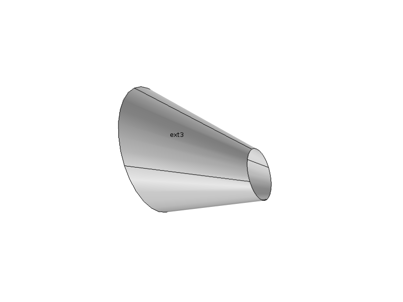

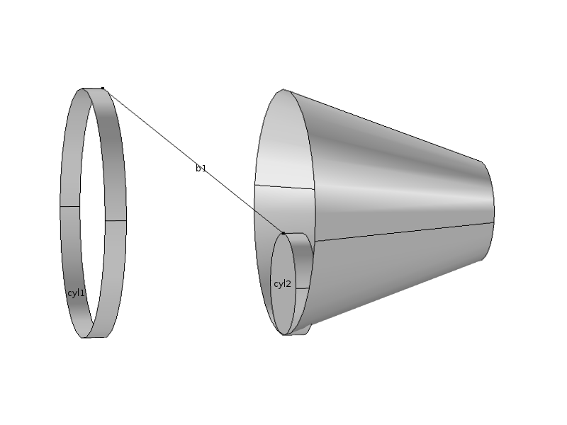

One, I would like to build a nozzle that has two different diameters but with a closed surface. I believe the simplest method would be "cone" geometry with diameter specified instead of angle. I need to negatively displace the second smaller diameter vertically. As a visual, I provide an image with two disks, and a linear Bezier polygon connecting the two disks. In front of the first connected images is a cone. I need to negatively displace the smaller diameter of the cone to a position that would allow creation of the geometry to the left but with a closed surface provided by the cone.

Finally, is there a way to actually enclose the surface between two disks (see image) that would allow me to also create a closed surface model of my nozzle? I was going to use the Bezier method, but that seemed counter intuitive since a single line is drawn.
