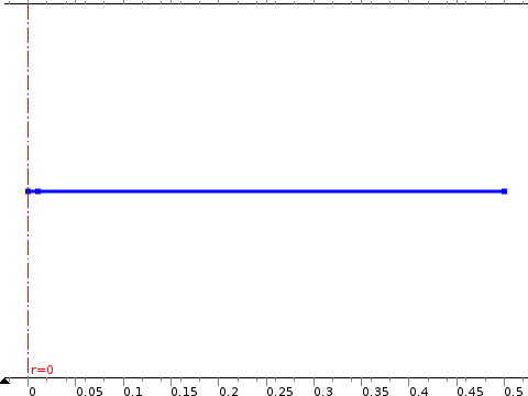

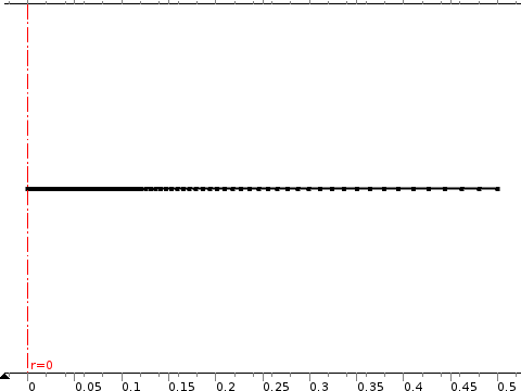

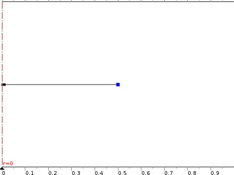

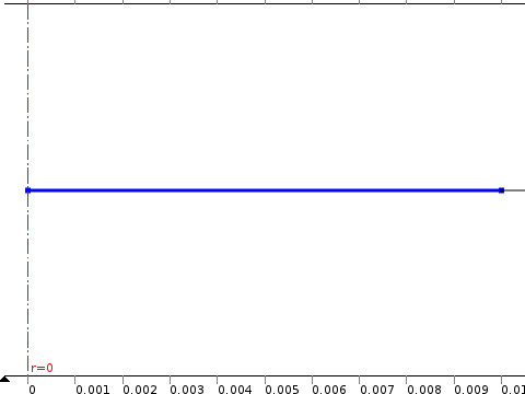

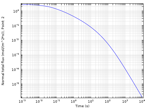

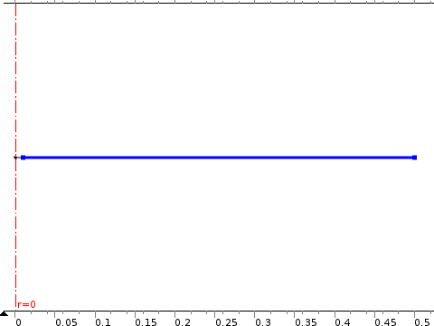

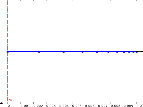

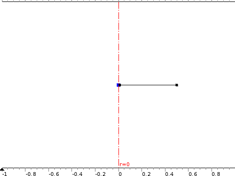

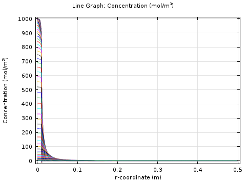

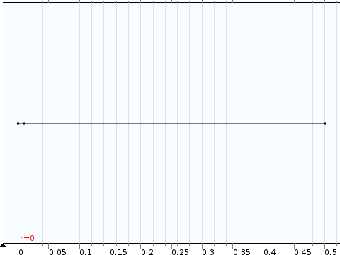

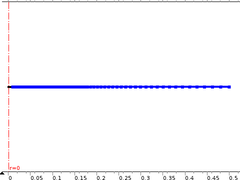

Your geometry is such that a 3D model is not needed. I made an axisymmetric 1D model for you, attached. I use version 4.4, I wish you can open it.
Also some figures from the model report are attached.
BR
Lasse
