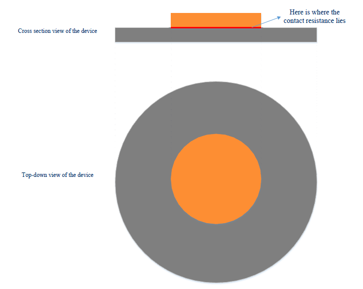

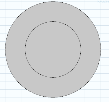

Another problem:In my 2D PDE model,there are two circle disk adhere to each other(I attached a picture of the model).And small and big disk are made of different materials. If I want to define the contanct resistance on the contact area,which boundary condition should I use in the PDE module? Thank you very much!

About the other question (contact resistance), I don't have clear if you refer to the contact between both discs, in the z direction (in which case your problem would have 2 fields of dependent variables, one for each disc) or you refer to the contact between the central disc and the surrounding circular band: in this case you can model the contact resistance in this way:
1. Use a different PDE mode for each domain (let's assume you have named the dependent variables J1x and J1y in one domain and J2x and J2y in the other).
2. Think on which variable must have continuity (in the contact line) and which one must not: I suppose both and must be continuous and can have a discontinuity. Let's assume that.
3. Set a boundary condition (BC) of continuity in one side (for instance at domain 1, Dirichlet BC: J1x = J2x and J1y = J2y).
4. Set a non-continuity BC at the other side, related to the contact resistance (at domain 2:
, or a similar relation, where is some scalar resistance in the contact line and is the unit vector normal to the contact line and pointing outwards from domain 2).

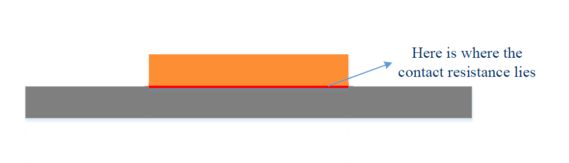

Actually,the contance resistance is the situation one as you understand! I attach two picture of the device, one of the cross-section and top-down views of the device. The other one is where the contact resistance lies. I simplified the 3D model into 2D model,which has bee proven to be right in several published papers.The two discs adhere to each other and the contact resistance lies on the contact surface. So the contact area is equal to the surface of the central disk.
I can't understand what you meant by "in which case your problem would have 2 fields of dependent variables, one for each disc".Can I solve the problem just as you describe above?

So it's the first option I told you about. And your problem hardly is 2D (well, it can be 2D axial-symmetry). If xy is the plane parallel to the discs, then surely you'll have a z component in J, and you talked only of x and y components. Things change.
Only if the main current density is parallel to the discs you can still use the 2D (xy-plane) model (in which case you still could use one PDE for each disc, and couple them through the continuity-contact resistance in the region of the small disc). So you have to think if you can neglect the z component of J, what I bid you cannot do. If you cannot neglect that component, perhaps the problem has axial symmetry (in the z axis, of course).
