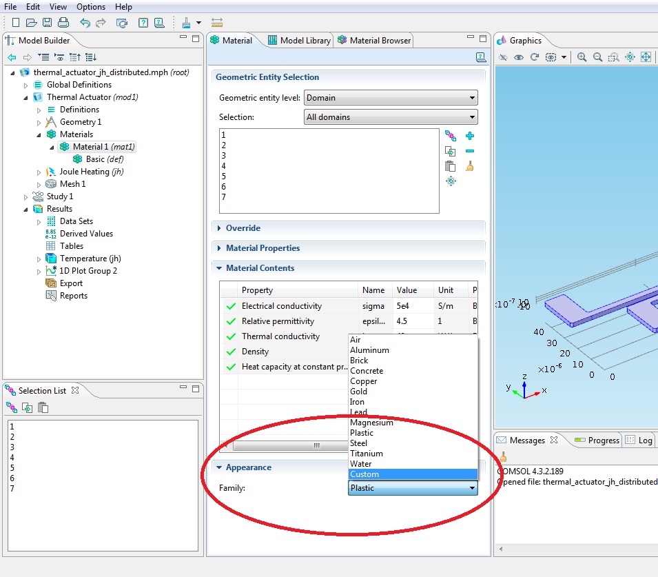

Hi Sebastien,
Once a material was added to the model, you can go to the bottom of its properties and find the Appearance options (see the screenshot).
Best Regards,
Dima.

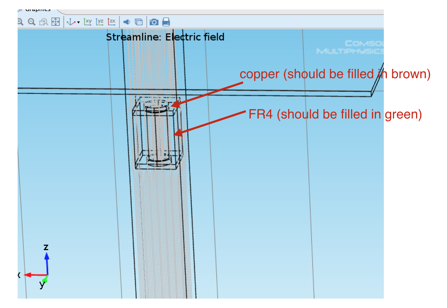

thanks for you answer. ok this is done but I cannot have the objects displayed and filled with the colours when plotting eg streamlines or a result of a computation (actually I can never manage to display with colours). See screenshot.
Cheers,
Sebastien

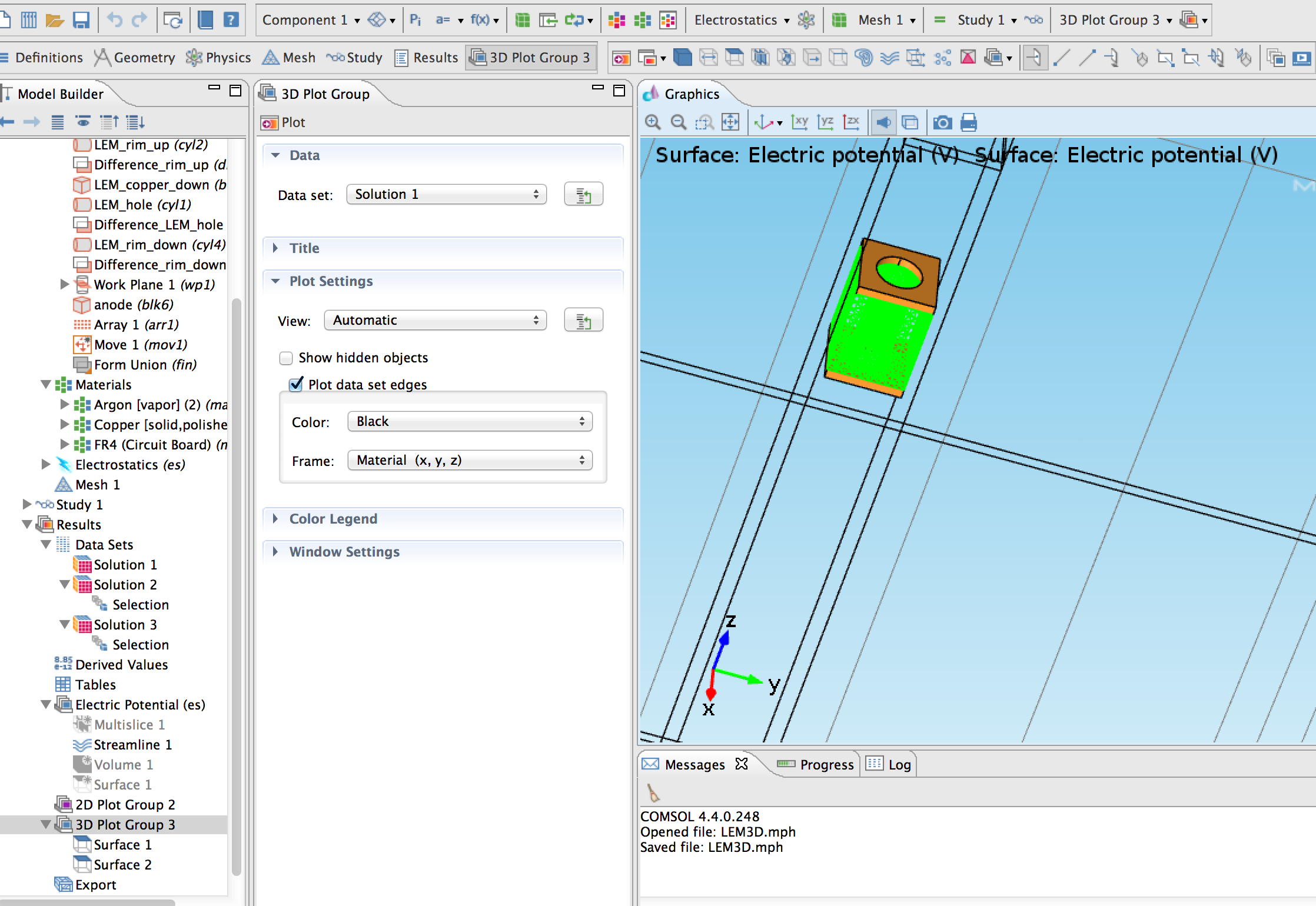

You can make the following steps:
1. Go to Results -> Data Sets -> Right click on the Solution -> Duplicate
2. Right click on the duplicated solution -> Add selection -> Select the domain/boundaries that you want to color
3. Plot Surface plot (any kind of surface plot), go to Data set of the Surface plot and select the duplicated solution from the list
4. Go to Coloring and Style tab, select Uniform color and choose the color
5. Go through the procedure for every material you want to color
Best Regards,
Dima.

ok getting there (see screenshot). But I cannot superimpose with streamlines. When I click on streamline the colours disappear and it goes back to transparent.
Just another general question. This method is a kind of workaround, there is then no way to use the colours I assigned to the materials for the solutions. Is there a way to actually display the material with its assigned colours even without superimposing the solutions. In other words what is the use of having material colours?

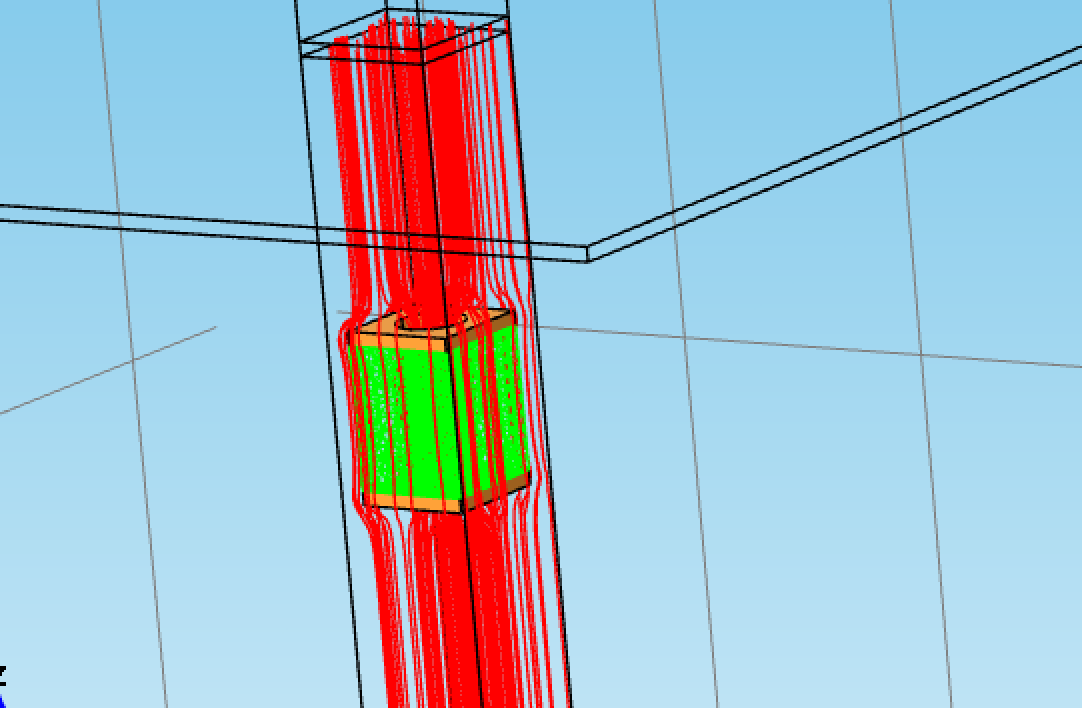

This is the only method i know. Hopefully someone will show us another one.
Plot both the streamlines and the surface plot under the same 3D plot group. Probably it will solve the problem.

yes ok thanks very much for you help this works.
But yes this is fine if you only have two objects to select but off course becomes impossible when the model will be more complicate. If someone knows a way to do this by simply using the assigned material colours it would be great (I mean there should be a way, otherwise what is the point in having material colours?).
