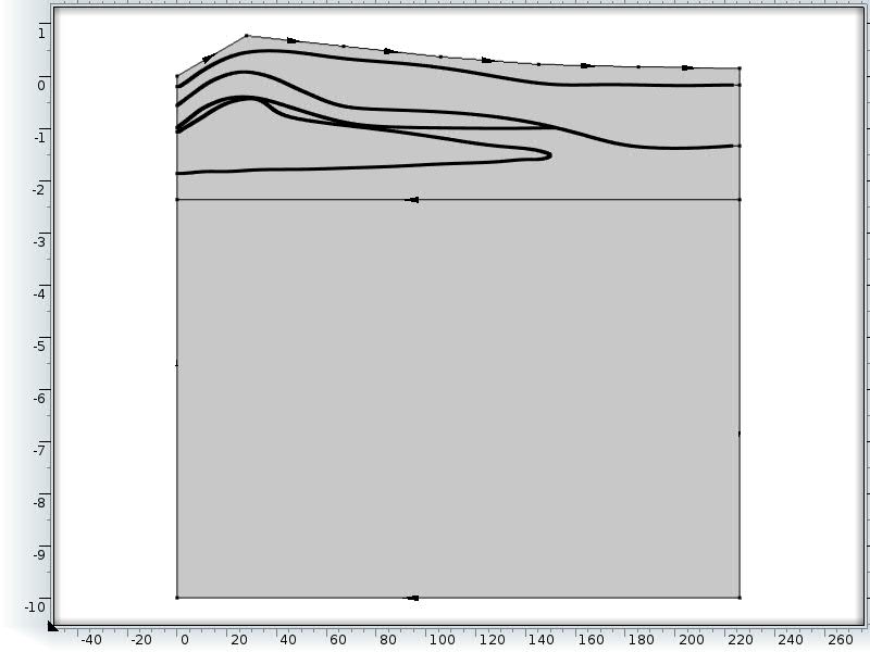

How is it possible to know value of special location in the surface that has not been defined as a point?
For example I want to know the value of Hydaulic head in a cross section fo soil column that I defined in 2D model for 20 different parts inside the surface?
Attached the snapshot of my case study.
Thanks in advance for your help.
Sepideh

After running your model, simply right click on "Data Sets" use "Cut Point 2D", then make a point graph with "Data set" selected to the name of the defined point.
