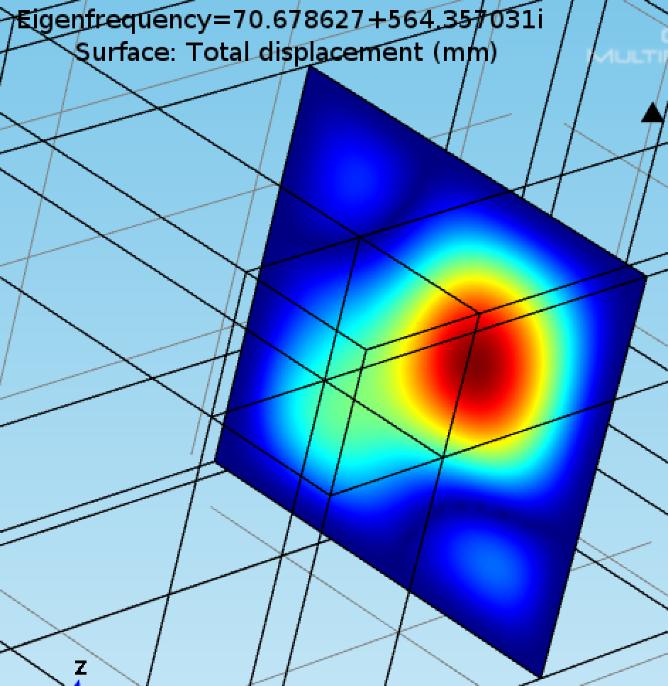

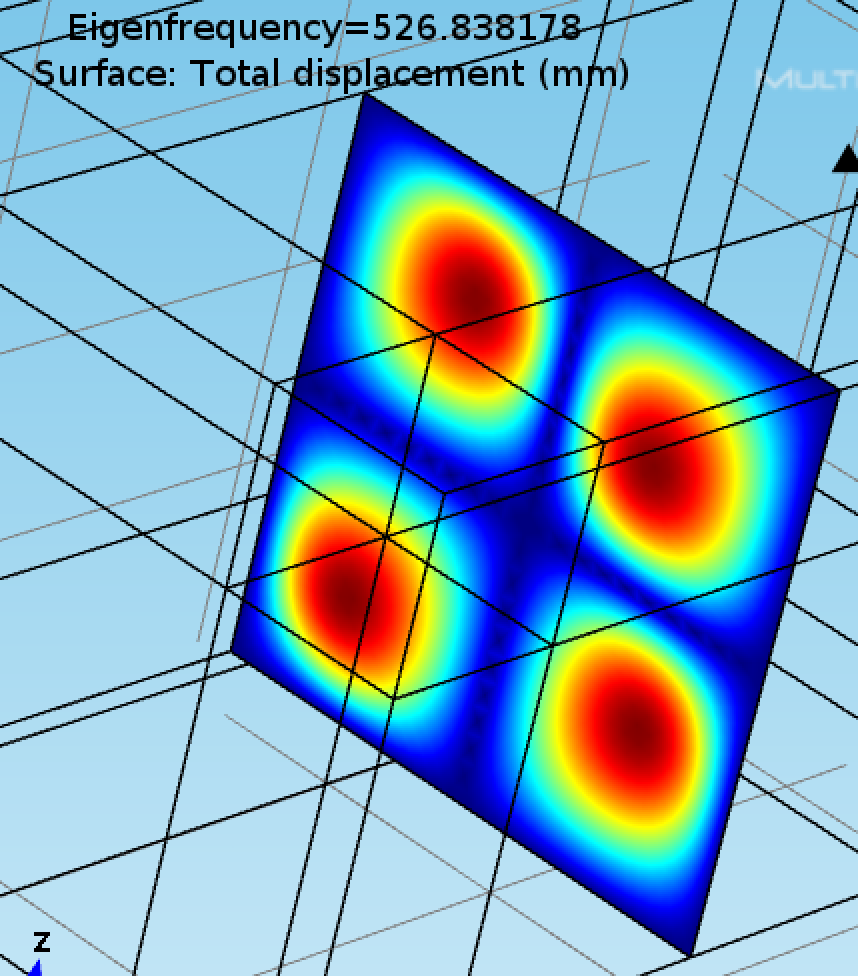

I can't get the Acoustic-Shell Interaction->Interior Shell->Linear Elastic Material to vibrate like a Membrane - displaying eigenfrequencies
Posted 2014/08/20 4:40 GMT-4 0 Replies
The Acoustic-Shell Interaction one gives ALL complex eigenfrequencies, whereas the Membrane just give real ones.
Anyone know why this is - or how to solve it?
