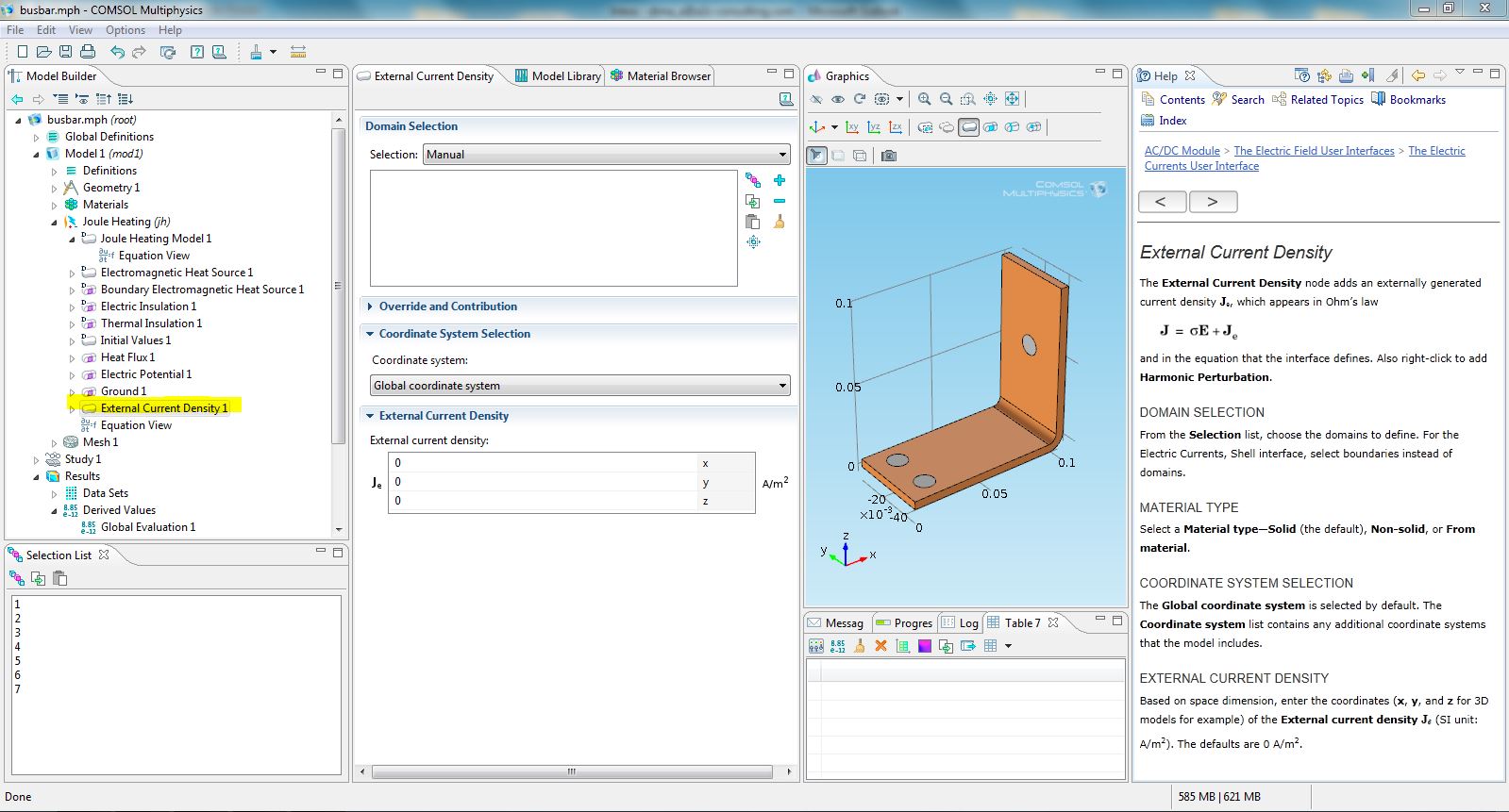

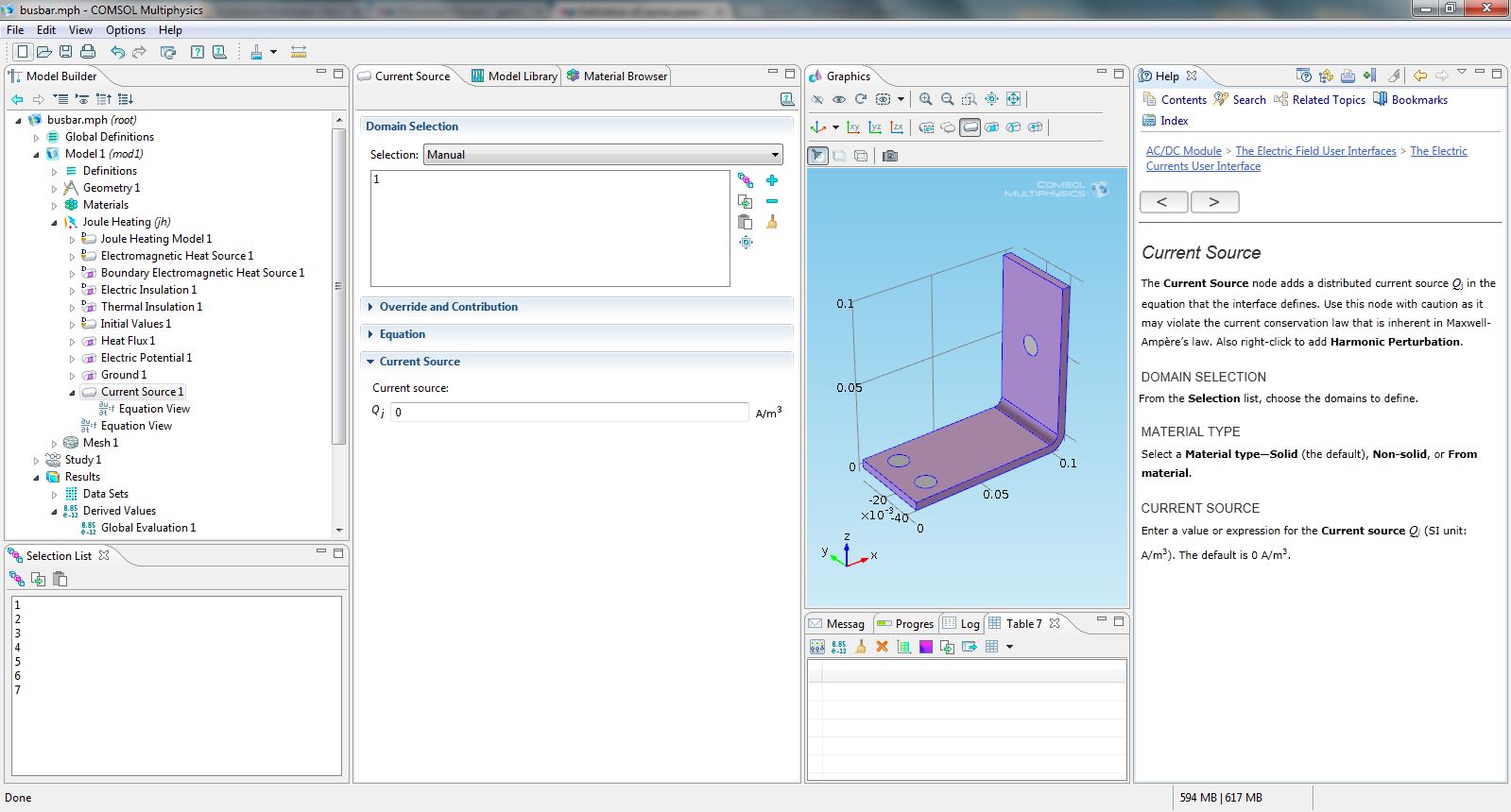

1. Qj is a distributed current source, see the screenshot with a definition.
2. Je is an external current density, see the screenshot with a definition.

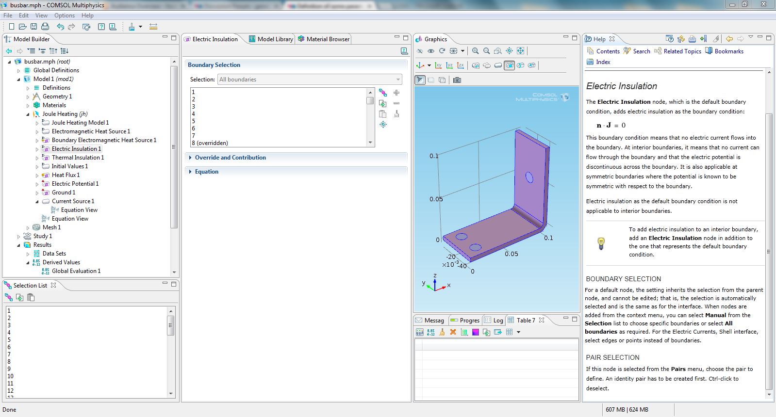

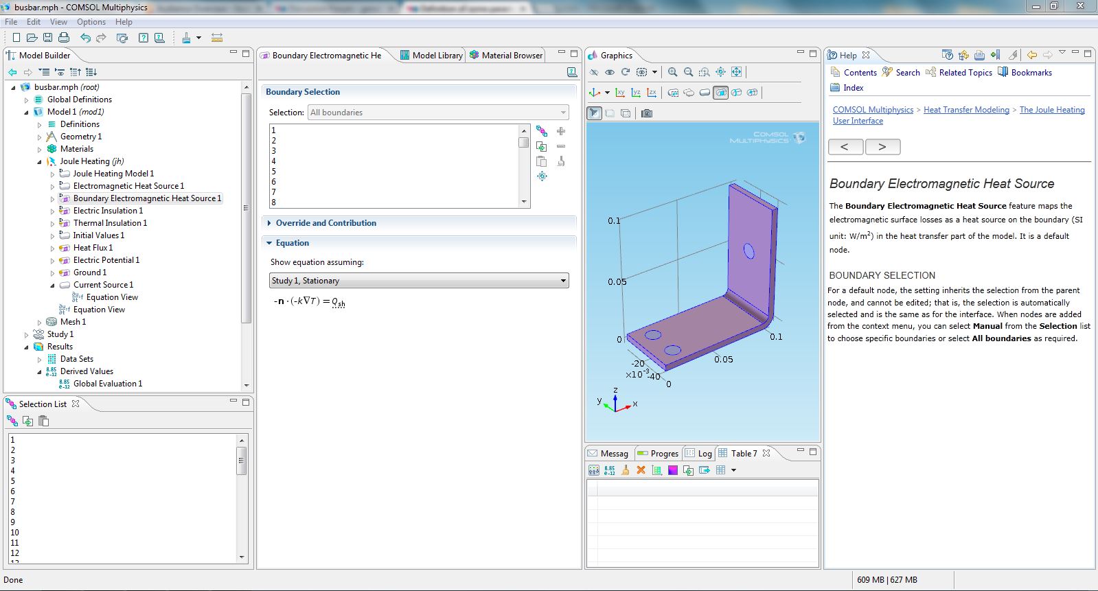

4. Compare the definitions of "boundary electromagnetic heat source" and "electric insulation" in the attached screenshots.

Hi Mohsen, 1. Qj is a distributed current source, see the screenshot with a definition. 2. Je is an external current density, see the screenshot with a definition. 3. Maybe "epsilon_0" is actually "epsilon0_const" - permittivity of vacuum? 4. Compare the definitions of "boundary electromagnetic heat source" and "electric insulation" in the attached screenshots. Best Regards, Dima. -- Dima Apter www.a2z-consulting.com
