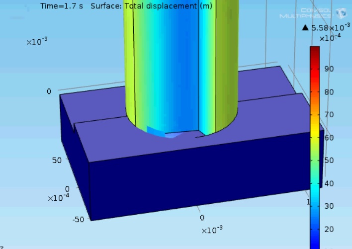

One more question. I'm trying to make the heat transfer simulation simultaniously with rigid body dynamics. Basicly I want to see a heat distribution on fixed workpiece while tool(with heat source on it) is rotating. Is it possible to do?
I found that results of simulations can be plotted seperately (in figure I can see just displacement), but I couldn't find simultaneous result option(to see temperature distribution while rotation).
