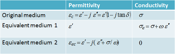

Michael,
Permittivity and electrical conductivity enters Maxwell wave equation for electric field in the combination
eps_c=eps-j*sigma/omega= (eps’-j*eps”)-j*sigma/omega
Therefore, medium can be considered alternatively either
-as a medium of real permittivity eps’ and effective conductivity sig_eff=sig+omega*eps”
or
-as a dielectric medium of effective permittivity eps_eff=eps’-j*(eps”+sig*omeg) and zero conductivity
Both formulations give the same result. In the example you are referencing to, the second approach is used since conductive losses of gold particle are frequency-dependent at optical frequency range and can be conveniently characterized by real and imaginary parts of permittivity.

Michael,
In most general case, medium might have dielectric and conductive losses. In that case, you enter in Comsol expression eps”-j*eps” for permittivity and sig for conductivity. This case corresponds to the “Original Medium” of the attached table. Alternatives equivalent ways to describe this general case in Comsol would be to enter expressions for permittivity and conductivity as “Equivalent Medium 1” and Equivalent Medium 2” as shown in the same table. You proved that this equivalent formulation formats give the same result when you typed eps=-9.7474-j*0.314625, sigma=0 or eps=1, sigma=10209-j*348730.
Now, gold particle is a good conductor and has no dielectric losses. Losses of metals as a function of frequency usually are available from experimental data in terms of real and imaginary parts of dielectric constants (see for example P.B. Johnson and R.W. Christy, “Optical Constants of the Noble Metals”, Phys. Rev. B, vol. 6, pp. 4370−4379, 1972). In this case, conductive losses are completely described by effective permittivity eps_ec=eps’-j*eps” which you enter as permittivity in Comsol. There are no other losses, hence you enter sig=0 for conductivity.
Regarding your question: “does it get sigma from relative permittivity based on their relation sigma=j*omega*epsilon0*(eps’-j*eps’’-1)?”
-No, Comsol reads conductivity value directly from the “Electrical conductivity” you specify in the Materials node.
Regarding you next question: “But when I typed eps=-9.7474-j*0.314625, sigma=10209-j*348730, the electric field enhancement changed. This puzzled me a lot. Can’t we input “eps” and “sigma” at the same time?”
-This is wrong, since you accounting for conductivity losses twice. Imaginary part of permittivity (0.314625) already accounts for conductive losses and therefore you must set sigma=0.

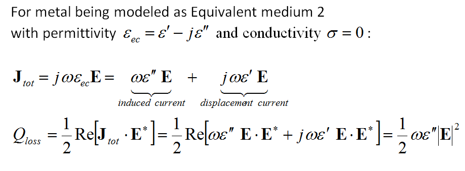

Michael,
Forgot to answer your question about induced current:
“In my model, I want to see “induced current density” and “charge distribution”. Since I set sigma=0 as comsol examples, when I choose “induced current density” to plot, there is nothing. Then how could I get “induced current density” and “charge distribution”?”
Induced current density is defined as Ji=sig*E. Since you set sig=0 then “there is nothing” under induced current density plot, as it should be.
Displacement or polarization current density is defined as Jd=j*omega*eps*E. You entered imaginary part in the permittivity for gold, which represent conductive losses here. Therefore, displacement current is actually induced current in this formulation.
Sergei

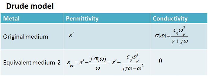

Posted: 1 decade ago 2014/10/05 19:15 JST
Hi, Sergei
Thanks for replying.
It seems that my theoretical study needs improvement to fully understand this “equivalent medium” and deal with it well. So let’s come to some conclusion and software operation which can solve my problem immediately.
The relative permittivity which comes from Johnson’s experimental data, in fact, is not the “original medium”, but “equivalent medium 2”. Is this understanding right? I regarded it as “original medium” before.

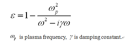

Then what about permittivity which comes from Drude model? Is it “equivalent medium 2” or “original medium”? ie, should we set sigma=0?
In my models, I usually use Johnson’s experimental data to define “eps”, just as example models. I want to plot charge distribution. Based on Maxwell’s equation in medium (see attachment 1), I entered “d(emw.Dx,x)+d(emw.Dy,y)+d(emw.Dz,z)” to plot. Is this right?Since D=eps*E, but here “eps” is from “equivalent medium 2”, I am confused whether D=eps*E is correct in this situation.
The “induced current density”. For “equivalent medium 2”, displacement current density has the expression in attachment 2. Its real part still has eps’’ except for sigma. Then why “displacement current is actually induced current in this formulation”?

1,how to plot charge distribution and induced current density.
2,If Drude model is used to define gold’s relative permittivity (its expression in attachment), should I set electric conductivity sigma=0 as well?

Michael,
1. In “Equivalent medium 2” formulation for metals, the effective permittivity is eps=eps’-j*eps” and conductivity is zero. Then the total current density is a superposition of the induced current
J_ind=omeg*eps”*E
and displacement current
J_d=j*omeg*eps’*E
There are losses associated with induced current and no losses associated with the displacement current, as shown in the attachment “Induced Current.png”.
You can plot induced current density using the above expression for “J_ind”. Expression D=eps*E is still correct in this formulation and you can calculate the charge density from the third Maxwell equation (Gauss law) as a divergence of the electric displacement.

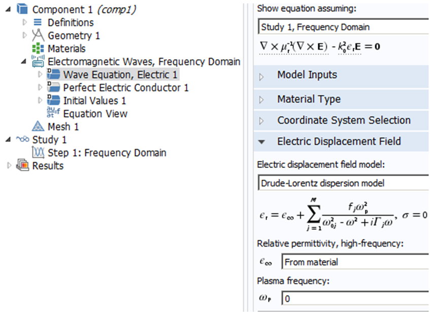

2. Drude model was originally developed for conductors and express metal conductivity as a function of frequency. Again, two equivalent formulations can be used to implement this model, as shown in the attachment “Drude Model.png”. Both formulations should give the same result.
As I understand, your intension is to use formulation “Equivalent medium 2”. In that case, you specify effective permittivity and set conductivity to zero.
Alternatively, you can use “Drude-Lorentz dispersion model” option available in Comsol under the node “Wave Equation, Electric/Electric Displacement field model”, as shown in the attachment.
