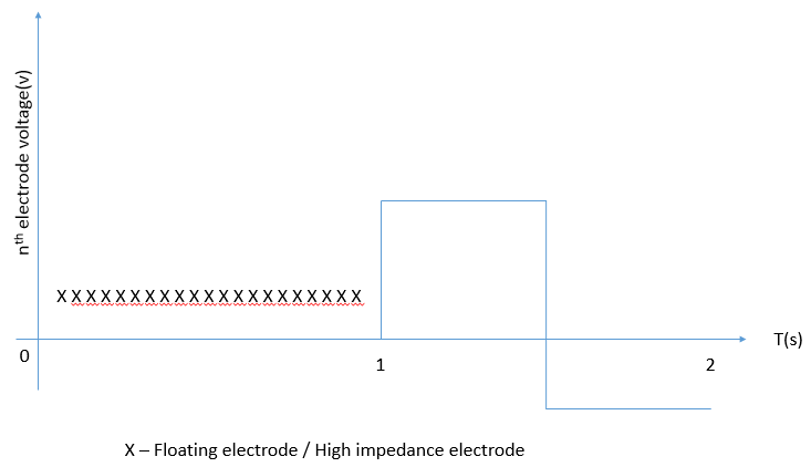

I have a system of electrodes that i'm trying to do a transient simulation on. I need to apply different voltage signals to different electrodes and measure the electric field. I have to make some electrodes "float" at certain time intervals.
Say I want to run the simulation for 2 seconds and in the time interval 0 to 1s I want a certain electrode to be floating. In the next interval 1s to 2s I want to apply a voltage pulse to the same electrode. Is there a way to do this. I cannot to simulate in two part(0 to 1s separately and 1s to 2s separately) because the effects in the first half affect the second half.
