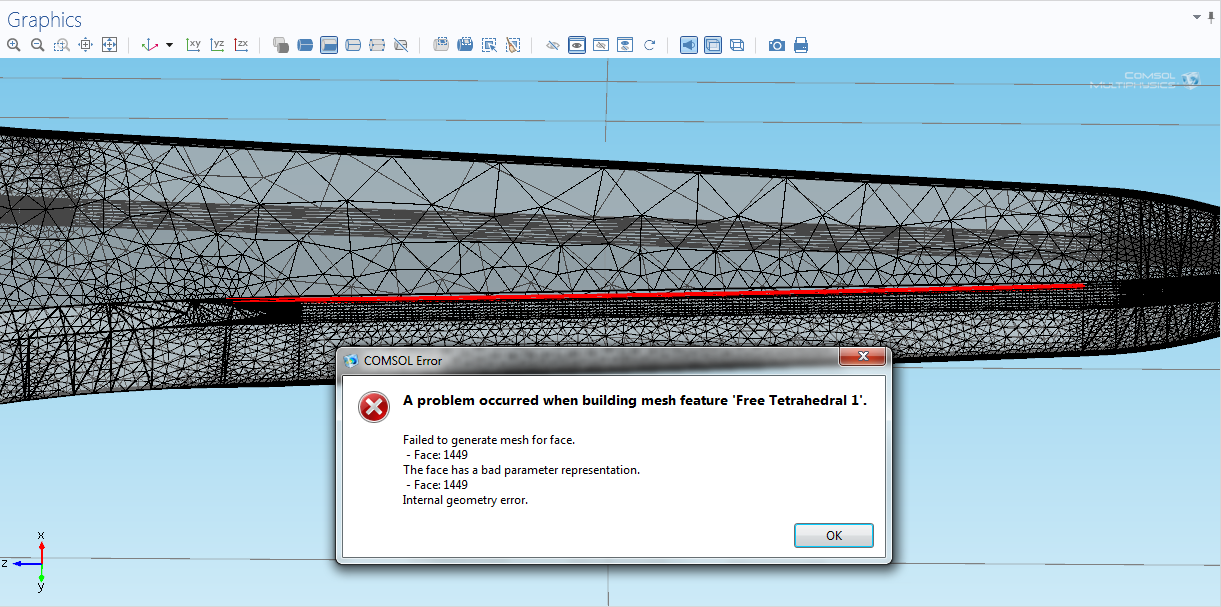

I try to insert a Geometry from an STL file in Comsol. Because the geometry is very small with rounding, I have set the "maximum boundary neighbor angle" to 1deg.
Unfortunately, if I want to create a mesh the following error appear:
A problem occurred when building mesh feature 'Free Tetrahedral 1'.
Failed to generate mesh for face.
- Face: 1449
The face has a bad parameter representation.
- Face: 1449
Internal geometry error.
How can I avoid this error?

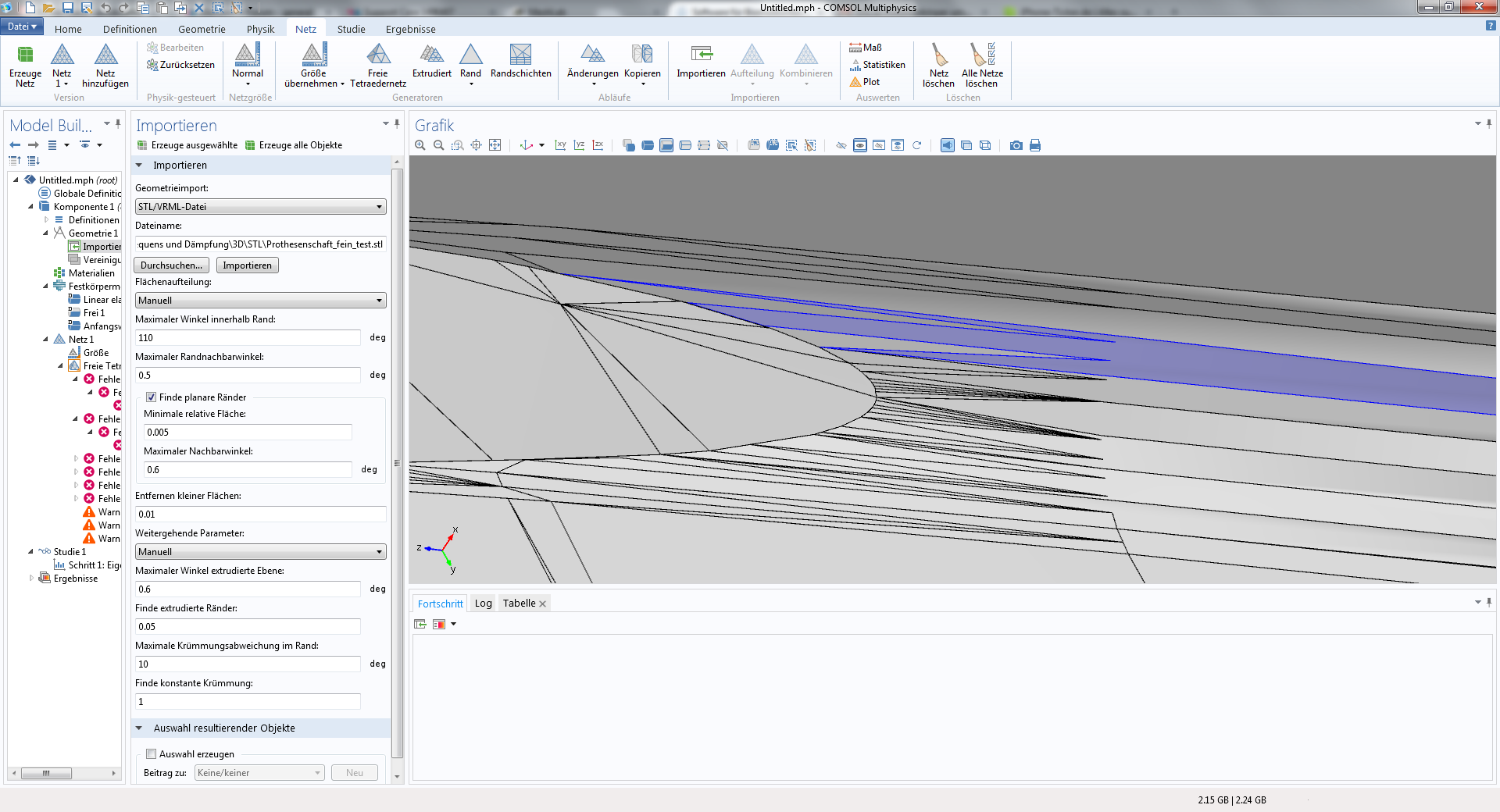

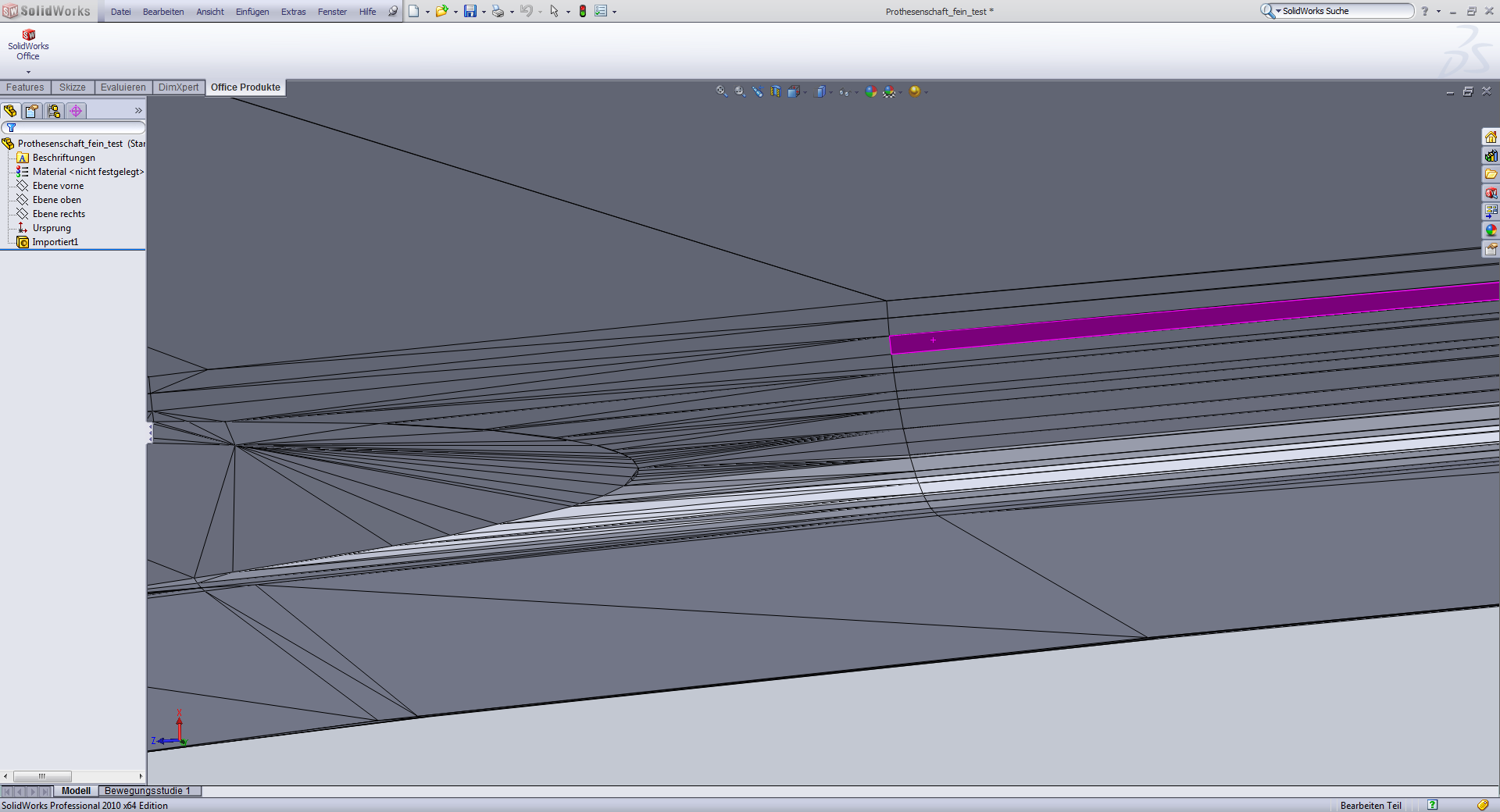

Dear Frank,
Thank you for your suggestions. Unfortunately I am not yet successful with many attempts.
I think the problem lies in the preparation of surfaces, I can open the STL file without any problems in SolidWorks 2010. And the surfaces in SolidWorks and COMSOL looks very different (shown in the screenshots).
Best regards, Thomas
