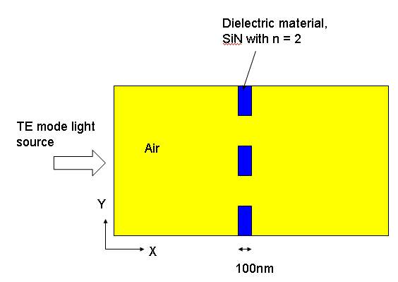

My model is as attched file, in which the blue one represents the dielectric material, SiN with refractive index of 2 (the dielectric material is periodic arranged and infinit long in the y direction) while the yellow region is defined as Air with refractive index of 1. My purpose is to simulate the transmittance and reflection of Plane wave going through the dielectric material arrays. Does anyone konws how to set the boundary conductions (BCs) on the up and bottom BCs and what does the BCs mean? Also, if I set the left BC to be port 1, which excite TE mode light source, what should the BC for right edge? For the dimensions of the model, what should I set for top, bottom, left and right to get the reasonable results, ie how is the length and width for the yellow air region.

left: add PML(x), and use scattering boundary condition with a source
right: add PML(x), and use scattering boundary condition without a source
top and bottom: PMC
simulation domain: 10 um is enough
Wenshan
left: add PML(x), and use scattering boundary condition with a source right: add PML(x), and use scattering boundary condition without a source top and bottom: PMC simulation domain: 10 um is enough Wenshan
