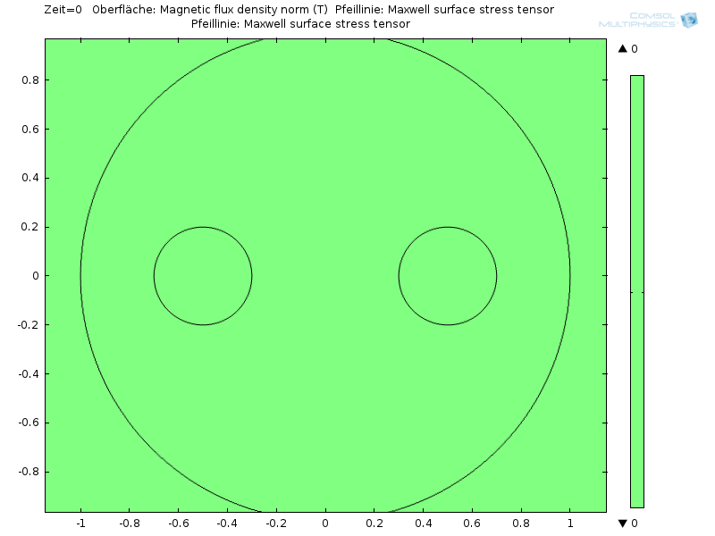

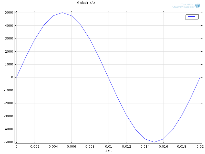

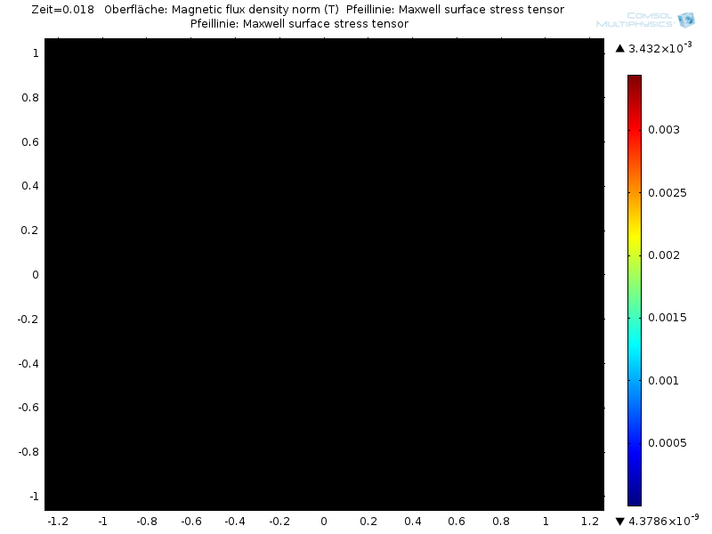

i have read the whole AC/DC Module User`s Guide, did some tutorials -  but im still trying to apply an alternating current like attached / as equation in that form in the MF-Interface (not MEF, because i need the time depended solver)?
sqrt(2)*Ipeak*exp(-(t[1/s]/(0.3)))*sin(versch)+sqrt(2)*Ipeak*sin(2*pi*FR*t-versch)
FR=50[Hz]
Ipeak=40[kA]
versch=2/3*pi
I attached a plot of the magnetic flux density at a specific time (18[ms]), 1d plot of the output diagram of the current, which i inputted and last but not least a normal result plot ( why ever its totally green)
Shall i use the electric circuits or better the electric currents interface to get this running at a geometric configuration handled in "parallel wires" from the model library ( the parallel wire model match my theme exactly ) but i would like to do this in 3D?
