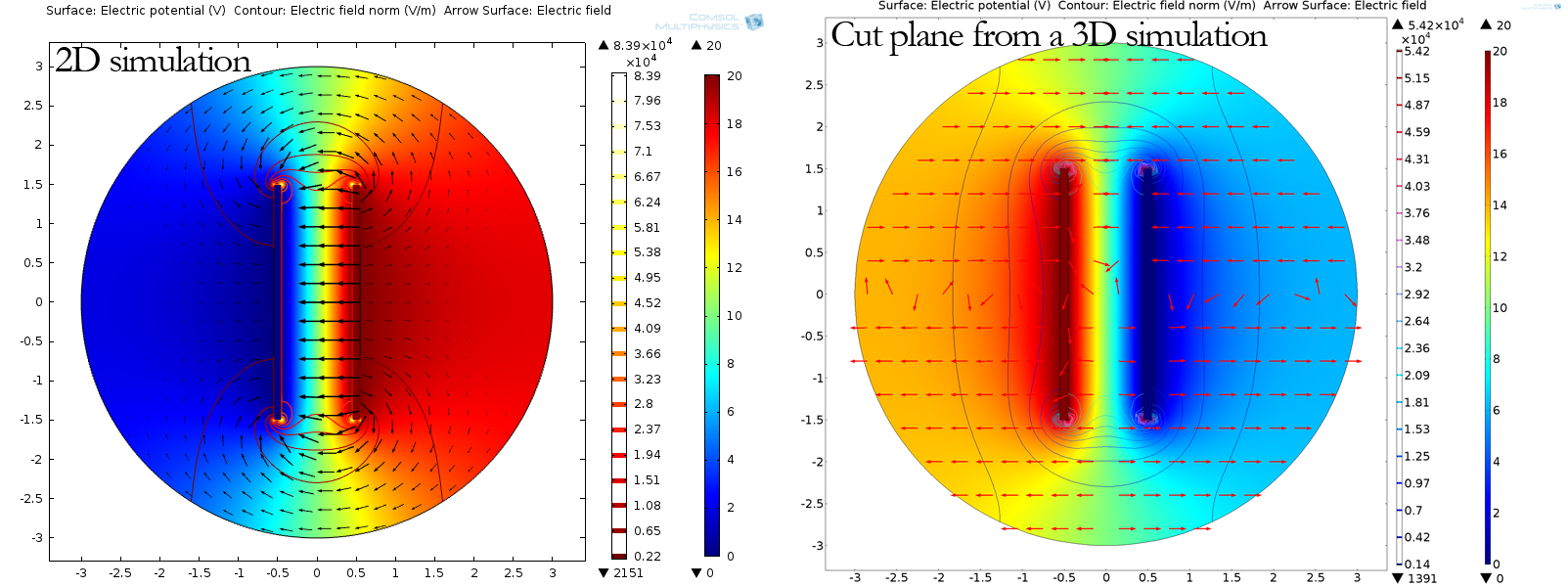

I'm a beginner COMSOL user. I came across this problem while i'm doing some test simulations. I've simulated a parallel plate capacitor in both 3D and 2D. I wanted to see if I can extract the same results from the 3D if I use a cut plane. So I created a cut plane so the resultant would be similar to a 2D situation. However when I extract the electric field directions, they do not look even remotely close to the results from 2D simualtion. I've attached two images from two simulations. I'm using "Electrostatic (es)" in both cases and all the materials are same in both cases. I would be very grateful if anyone can point out what I'm doing wrong.

something must be wrong with the arrow surface plot. If you upload the model (delete the solution if it is too big) we could have a look.

Thank you for your reply Edgar. Original file size was about 50MB and it did not change even I deleted the solution and mesh. Therefore I created another file similar to the original file. Please find it attached(3MB).
All I did was simulated the model and created a 2D plot with a potential surface and a arrow surface representing the electric field. (I used a cut plane on the zx plane.)

I modified your model according to your description, looks ok to my taste. You didn't send your model so I can't say what is wrong there.

Check whether in the arrrow plot in your 3D cut plane you are plotting the _in-plane_ components of the E field. I suspect you are not.

Thank You for your responses. Jeff you were spot on. My plane was a xz plane and I was plotting x and y components on the plane(beginner mistake). Now that I corrected it, it looks the way it should be. That was a great tip to subtract the blocks from the sphere.
