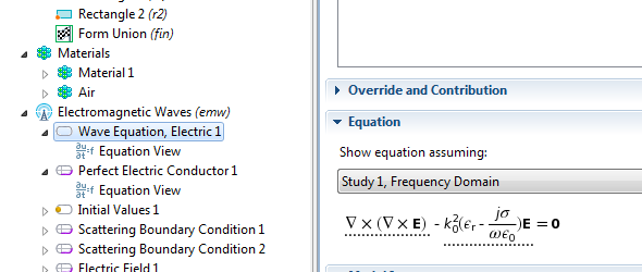

I have an electromagnetic simulation where I would like to change the wave equation in a domain (I'd like to add a source term) and have COMSOL work with that.
In the attached image you can see the Model Builder tree with the Wave Equation item selected. To the right there's the equation. I'd like to change it so instead of the equality to zero, it would be equal to something else.
I found the "Equation View" item (also shown in the image), however, I couldn't find a textbox with the wave equation. I started reading about "weak from" but I'm not sure it's what I'm looking for.
I'd appreciate some direction.
Thanks
[QUOTE] Enable this option: http://cl.ly/101N [/QUOTE] Hi, The link above is missing at this time. I have an electromagnetic simulation where I would like to change the wave equation in a domain (I'd like to add a source term) and have COMSOL work with that. In the attached image you can see the Model Builder tree with the Wave Equation item selected. To the right there's the equation. I'd like to change it so instead of the equality to zero, it would be equal to something else. I found the "Equation View" item (also shown in the image), however, I couldn't find a textbox with the wave equation. I started reading about "weak from" but I'm not sure it's what I'm looking for. I'd appreciate some direction. Thanks

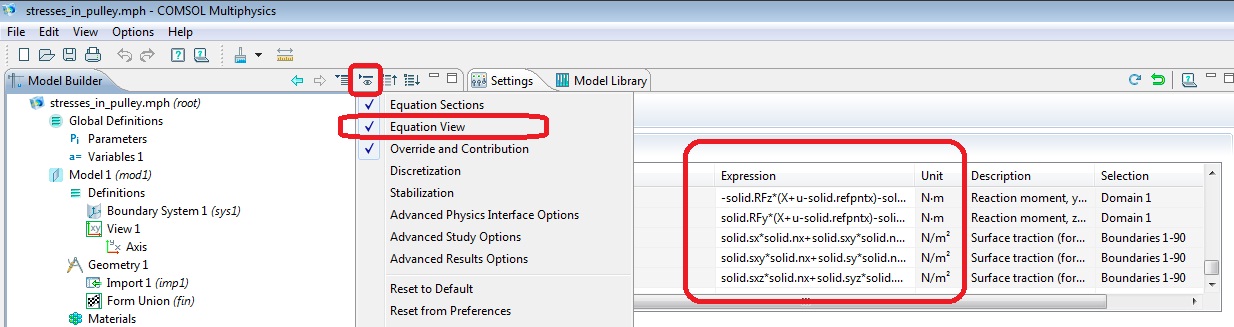

Posted: 1 decade ago 2011/11/21 1:33 JST
Enable equation view using the icon right to the the model builder tab.
Pls find the attached image for more details.
I hope this answer your question. If you still do not resolve the problem,
share your file.
Rakesh
Hi, Enable equation view using the icon right to the the model builder tab. Pls find the attached image for more details. I hope this answer your question. If you still do not resolve the problem, share your file. Rakesh

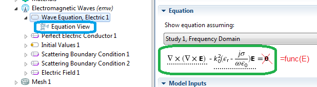

Posted: 1 decade ago 2011/11/21 19:49 JST
Thank you for the quick reply. I found what you were talking about, however, I do not understand where (or even IF) I can modify the equation.
I'll rephrase: in the attached image the equation is marked in green, to the right. I would like to add an arbitrary source term to it, as depicted. To my understanding, I should click "Equation View" (marked in cyan to the left) and modify something there, but, I do not know what. Nothing seems similar to an equation, nor to an intuitive "curl(curl(E)) - ... = 0" definition.
I've been looking in the COMSOL documentation, but it's so vast I can't sort through it..
Any help is appreciated.
Hi, Thank you for the quick reply. I found what you were talking about, however, I do not understand where (or even IF) I can modify the equation. I'll rephrase: in the attached image the equation is marked in green, to the right. I would like to add an arbitrary source term to it, as depicted. To my understanding, I should click "Equation View" (marked in cyan to the left) and modify something there, but, I do not know what. Nothing seems similar to an equation, nor to an intuitive "curl(curl(E)) - ... = 0" definition. I've been looking in the COMSOL documentation, but it's so vast I can't sort through it.. Any help is appreciated.

Posted: 1 decade ago 2012/05/14 20:00 JST
The vector equation must be divided into components to be able to implement in COMSOL. So what you see in the equation system contains partial derivatives rather than vectorial operators. It is not difficult to identify the components of Maxwell's equations correspondingly.
Cheers!
[QUOTE] Hi, Thank you for the quick reply. I found what you were talking about, however, I do not understand where (or even IF) I can modify the equation. I'll rephrase: in the attached image the equation is marked in green, to the right. I would like to add an arbitrary source term to it, as depicted. To my understanding, I should click "Equation View" (marked in cyan to the left) and modify something there, but, I do not know what. Nothing seems similar to an equation, nor to an intuitive "curl(curl(E)) - ... = 0" definition. I've been looking in the COMSOL documentation, but it's so vast I can't sort through it.. Any help is appreciated. [/QUOTE] The vector equation must be divided into components to be able to implement in COMSOL. So what you see in the equation system contains partial derivatives rather than vectorial operators. It is not difficult to identify the components of Maxwell's equations correspondingly. Cheers!
