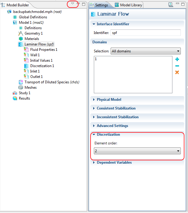

Posted: 1 decade ago 2010/05/10 7:11 GMT-4
Hello Davis,
to the right of the Model Builder tab, there is a "View" menu button. It has a small upside-down white triangle on it. There, select "Show more options". Then go to the physics node, for example, Laminar Flow. In the settings windows, you find the Discretization area and Element order. See attached screenshot dicretization.png. I highlighted with red the areas of interest.
We added the "Show more options" feature to make the interface cleaner.
Niklas Rom, COMSOL

Posted: 1 decade ago 2010/05/10 17:46 GMT-4
Hi Niklas,
Got it! Thanks!
This selects the element order of the default assigned type. How does one select among various element types, or shape functions (shlag, shdisc, shbub, etc.)?
Thanks again for your help,
Dave
Hi Niklas, Got it! Thanks! This selects the element order of the default assigned type. How does one select among various element types, or shape functions (shlag, shdisc, shbub, etc.)? Thanks again for your help, Dave
