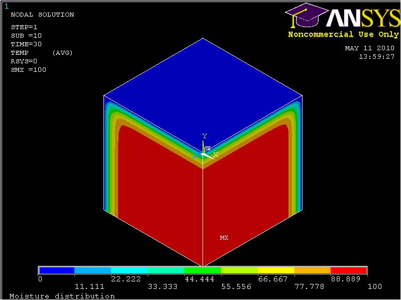

I agree the initial and boundary conditions are not realistic. a sudden jump is definitely expected. I have tried running the model for longer times (500, 1400 sec etc.) to see if the initial jump eventually smooths out. But it did not.
I did the same exact analysis in ANSYS and got the result as expected (temperature distribution within 0 to 100) I have attached the result.
