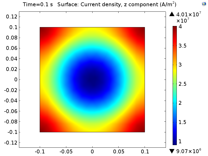

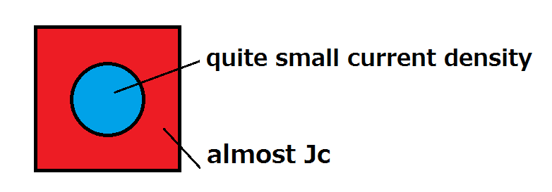

We are trying to simulate a conductor and current density on the cross-section needs to be distributed like attached figure 'finial'. At the beginning of simulation, we set a uniform conductivity at the cross-section and get current distribution like attached figure 'initial'. Then we compare the current density with the Jc (which is a value shown in figure 'finial'). According to the comparison, we revise the conductivity and calculate again. So we would get the current distribution like figure 'finial' after iteration. All in all, our aim is to adjust conductivity so that the current density could be distributed like figure 'finial'.

Jing,
If the conductivity could be described as a parameterized equation, then it would be a candidate for the Optimization Module. At first glance, that may not be possible, at least easily.
The approach I would consider is to add a Coefficient Form PDE physics to your model and define the conductivity as its dependent variable, allowing you to solve for it on the mesh. You would then create a PDE that would describe conductivity in such a way as to represent the difference between your solution electric field and your desired field, which should converge the conductivity to the desired value.
I have not yet tried this approach, but these are my initial thoughts.
