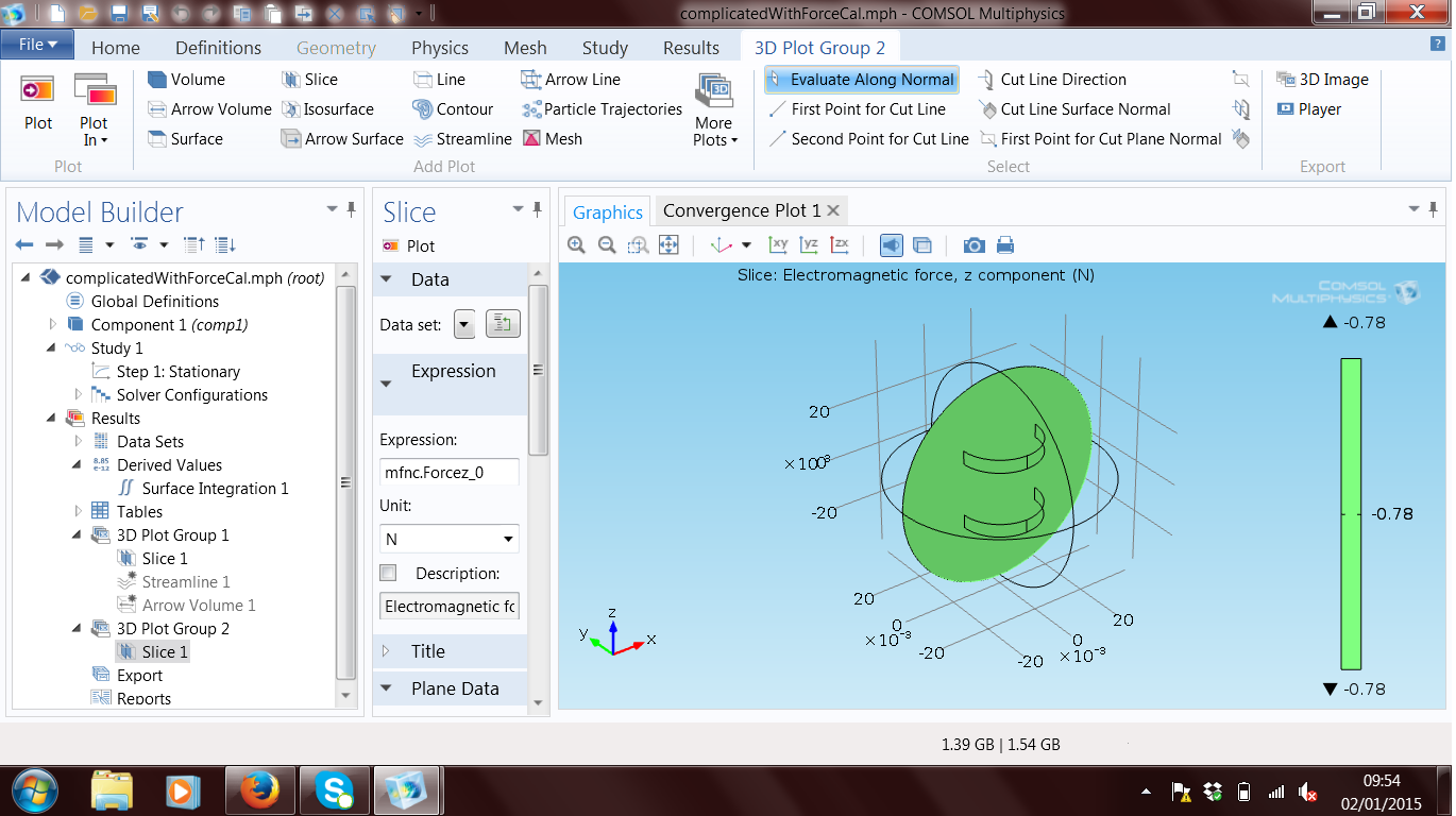

I am having trouble understanding the force calculation between two permanent magnet in COMSOL. My attached model can find the force but this force is different from the analytical expression for the force which can be found here: (Force between two cylindrical magnets) en.wikipedia.org/wiki/Force_between_magnets#Force_between_two_bar_magnets. In COMSOL the force will change if I change the air sphere size? Any idea about the correct size of sphere with respect to size of magnets?

The Force Calculation feature in COMSOL is based on the surface integration of the Maxwell Stress Tensor. This is very sensitive to the mesh size. So, you would probably need to further refine the mesh and calculate the force. Keep refining the mesh until you get almost constant force for successive mesh refinement. The size of the air domain should be such that the fields on the outer boundaries should be negligible. You could also try using the Infinite Element Domains or increase the air domain further.

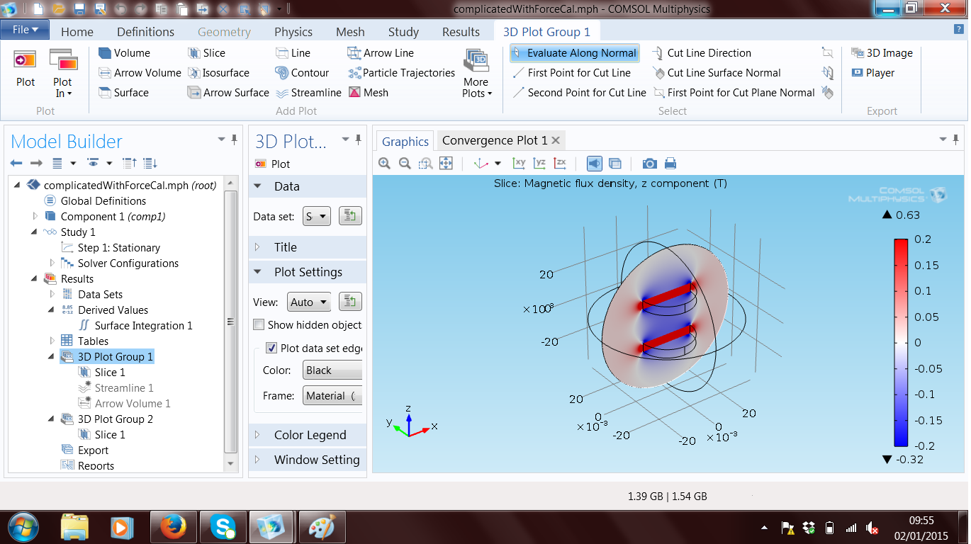

In response to your instruction, I investigated incrementing the sphere radius and set mesh refinement to "Extremely Fine". My results were:

I cannot see any clear trend here, and from the magnetic flux density plot, I think that increasing the sphere radius further will not reduce edge effects significantly. which suggests that I have made an error in setting up the force calculation (Model Builder > comp1 > mfnc > Force Calculation 1). Have I set up this calculation correctly? I am also unsure if I have set up boundary conditions appropriately.
Following the procedure outlined in [1], I was able to upload my model file without mesh and results which should help with resolving this problem.

I checked your model. If you only need to calculate magnetic force between the two separated cylinder magnets in your problem:
You should not define magnets by Material, as the magnets can be assumed to have linear behavior. So, you need to define them in Magnetic Flux Conservation node. But, using this node you assigned magnetization to the air sphere, why ???? This is the reason that when you increase the air sphere radius your force changes. Following some solved examples in COMSOL about permanent magnet, you can solve this problem easily.
