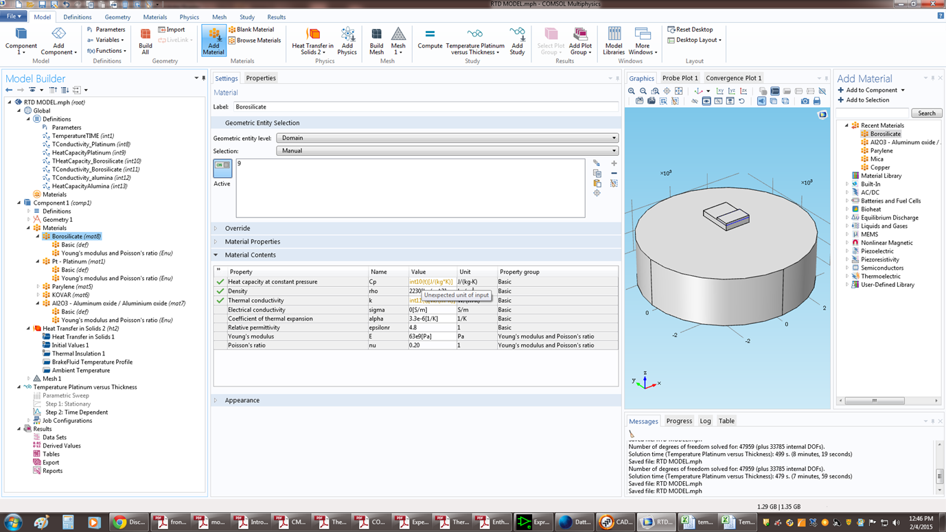

2.- I am also including in my model temperature dependence properties, this was done with a interpolation function that is being called in the Materials property section for the corresponding property. However, I am getting a strange warning message : "Unexpected unit of input", although this message is not stopping the simulation I am worry about if this can lead to a wrong result. I am attaching a screenshot

Your interpolation table int1 gives temperatures in degC, try K if it resolves the input unit problem, I am not sure.

I will try with the meshing, thanks for your recommendation. Regarding the interpolation table, I already try changing the units and the warning message still there, looks like is not a error because I can run the model without the parametric sweep and get results.
