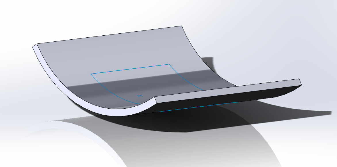

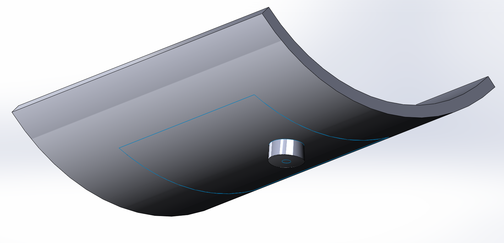

Thank you very much for your help. Actually I have already tried what you mentioned however I have stuck when I was trying to draw mounted concentric cylinders which are mounted on the concave surface. Do you have any idea if I can draw those cylinders too?
[QUOTE] This is not very elegant, but will this do? If you don't have version 5.0, this is the procedure: 1. Create a hollow cylinder and cut it with, e.g. blocks to a desired shape. 2. Draw another block across this tubular wall. 3. Partition the last block. 4. Convert this partition to curves. 5. Remove extra edges. br Lasse [/QUOTE] Thank you very much for your help. Actually I have already tried what you mentioned however I have stuck when I was trying to draw mounted concentric cylinders which are mounted on the concave surface. Do you have any idea if I can draw those cylinders too?

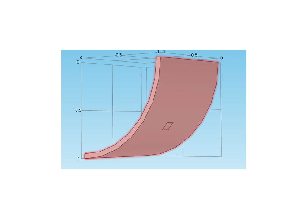

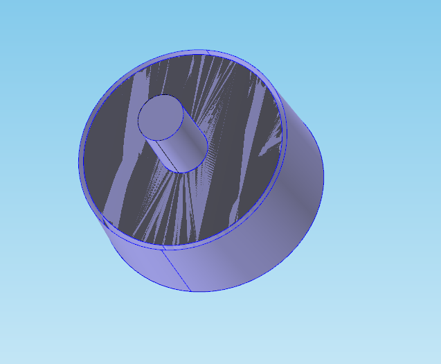

Thank you very much for your advise. I have already tried to Import my CAD file as well. However I have got some geometry issues. So my simulation didn't work properly. I think the attachment explains my problem much better.
Do you have any suggestion for this problem?
