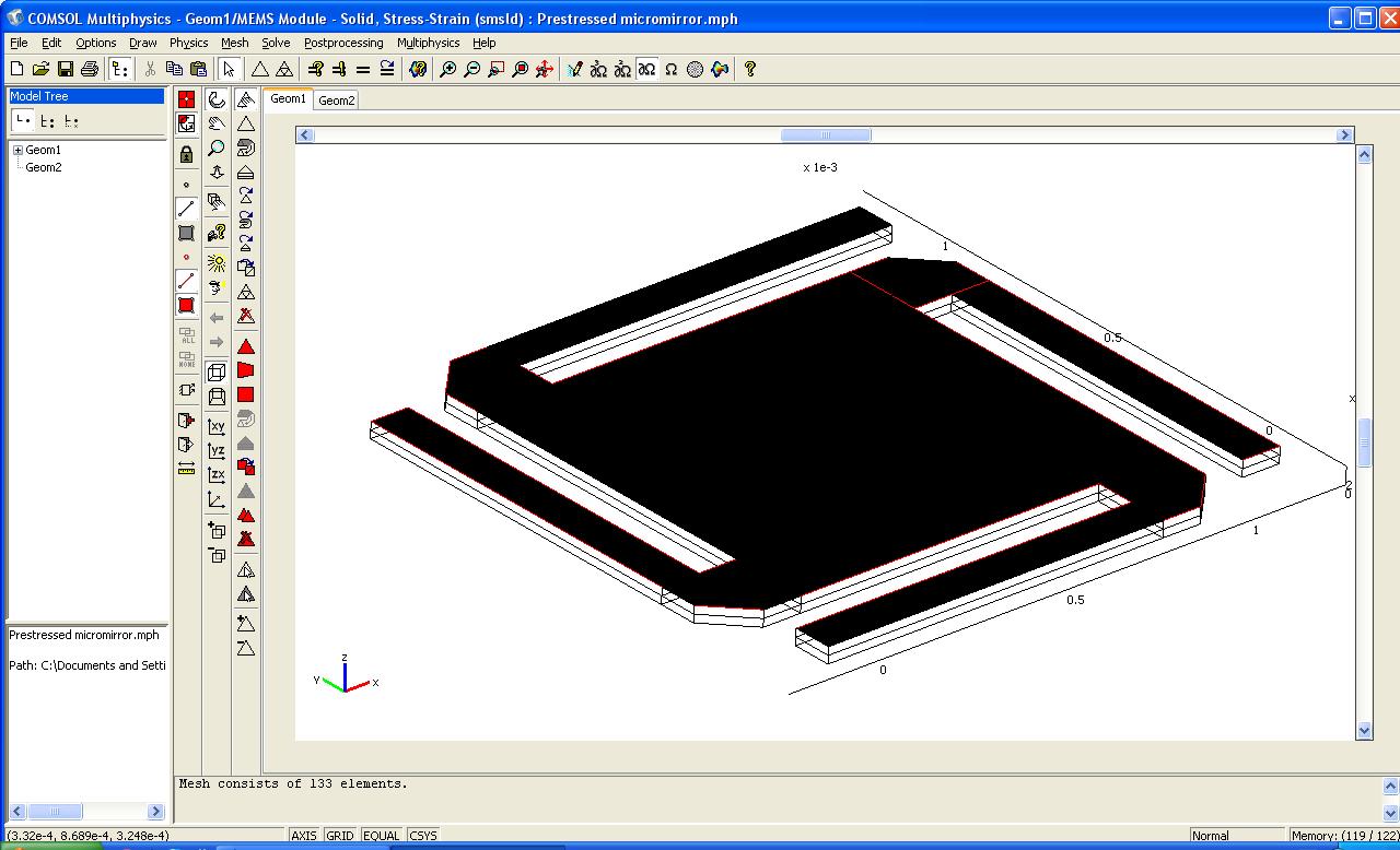

And last question. I have huge problem with mesh visualization. In the beam surface after meshing I have totally black surface, while on the back and sides everything is fine (see picture in attachment). I have no idea what to do, may be somebody has some ideas???

First of all, is it 3.5 or 4 you are using ? your image looks like 3.5 so I'll assume that.
For the mesh, it's black, but how many surface elements do you have? probably some hundred tousands, and they are so tightly packed that you cannot see through, you need a hughe multicore and GB ram PC to get that calculated without ram limitations, but that is another issue.

Thank you, Ivar for you previous letter! It was very helpful! However I still have some questions left
1) you asked me which version do I use. I use 3.5
2) the 'black area' problem is not solved at the moment. I used really coarse mesh (713 elements) and it was still black. Moreover after simulation this black area remained. However on the back area and on sides everything is fine, the problem is just on the top surface. Is there something I can do with it? Or is there a problem with my PC?

for me the "black area looks like a fine mesh (typically what I get with fine meshes) or is it linked to extra points showing up?
Check your settings in View Visualisation ...

Hello, Ivar!
You were right, my black spot problem was solved after some playing with visualization properties. I just activated the 'headlight' mode with white color and the problem was solved. However only in 3D. For 2D I still can't find any solution... But I don't really need it now, 3D is what I need.
