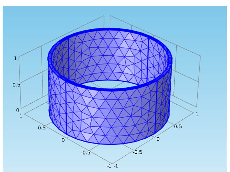

Posted: 1 decade ago 2015/02/11 5:28 JST
No problem, if you first mesh the inner surface. Look at the attached image.
Lasse
No problem, if you first mesh the inner surface. Look at the attached image. Lasse
Posted: 1 decade ago 2015/02/11 5:31 JST
Thank you,
It appears my problem is occurring because the hallow tube is touching the plate. I am able to mesh the hollow tube when it is not in contact with the plate. I am not sure how to resolve this issue when the tube is touching the plate which is required in my model.
Thank you, It appears my problem is occurring because the hallow tube is touching the plate. I am able to mesh the hollow tube when it is not in contact with the plate. I am not sure how to resolve this issue when the tube is touching the plate which is required in my model.
Posted: 1 decade ago 2015/02/11 5:40 JST
The problem is that swept mesh creates rectangular elements on the cross section of the tube, while your plate has triangular ones, and they do not comply. I have to think about this for a while, but now I think that it is not possible to have a swept mesh both in the tube and the plate for the reason above.
br
Lasse
The problem is that swept mesh creates rectangular elements on the cross section of the tube, while your plate has triangular ones, and they do not comply. I have to think about this for a while, but now I think that it is not possible to have a swept mesh both in the tube and the plate for the reason above. br Lasse
Posted: 1 decade ago 2015/02/11 6:32 JST
I was wrong, it was rather straightforward. First I meshed the tube, then the remaining parts of the plate surface. Finally swept mesh across the plate.
br
lasse
I was wrong, it was rather straightforward. First I meshed the tube, then the remaining parts of the plate surface. Finally swept mesh across the plate. br lasse
