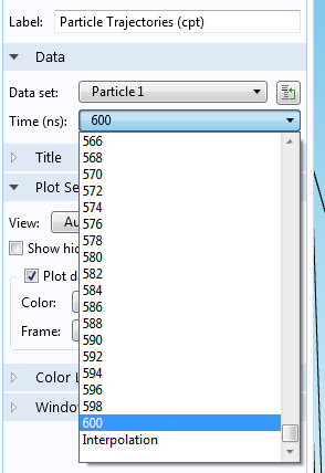

The particle tracing module requires that we select a time to plot our trajectories up to (see attachment), can this only be set by the pull down window? The first time a simulation is run, COMSOL will plot from the first time step to the last time step, say from 0ns to 1000ns. However, when a second simulation is run for a longer duration, say 6000ns, COMSOL will still only plot from 0ns to 1000ns. When running my own simulations, this was not a problem even though it was a hassle because I could always tell COMSOL to plot to the last time step from the pull down window. However, with the application builder, the app user is stuck using whatever time step he or she chose first. How can I fix this? Is there anyway to set this with a parameter so that the app user can control this?
