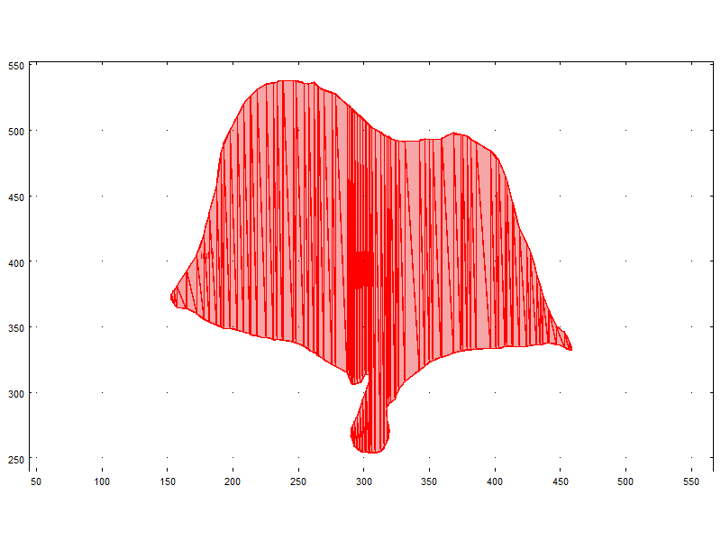

I am trying to import a geometry from a DXF file. However, the imported object has many domains, which makes the meshing unacceptably slow. Furthermore, the interior boundaries are unnecessary, and make it hard to select the boundaries for which I need to set initial conditions. So, is there a way of "merging" all the domains into one and getting rid of the interior boundaries? Please see attachment to get an idea of what I'm talking about.

In comsol 4, after importing make a Union, and check the remove internal boundaries option. does it work?

Exactly what I needed. Thanks!
