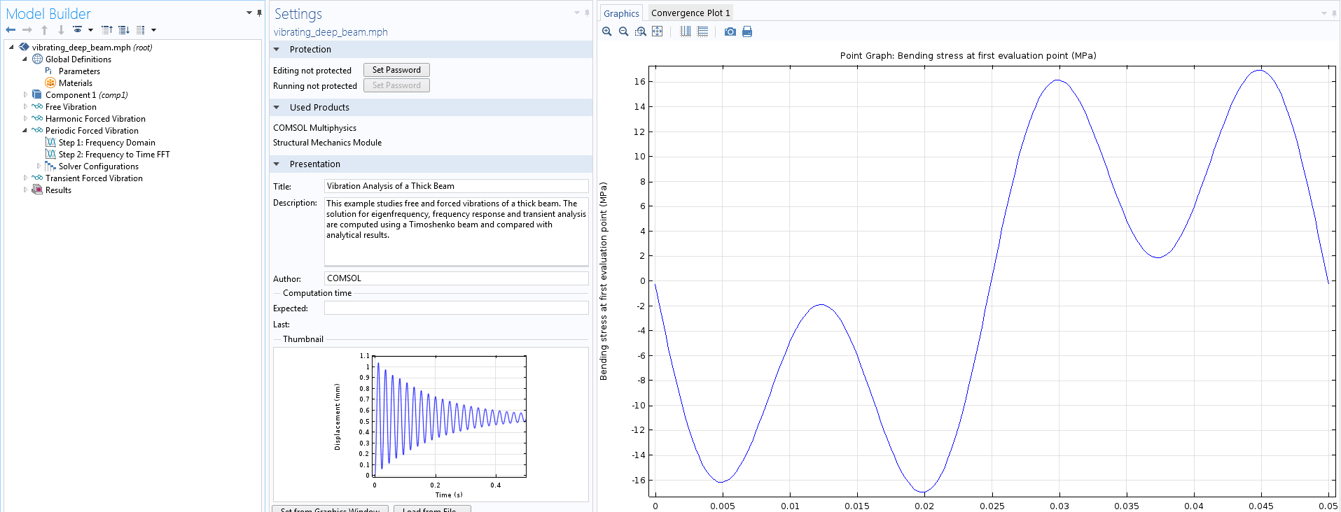

By using a 'Frequency to Time FFT' study step you can generate a time history from frequency domain results, even for several frequencies.
Look at the third study in this example:
www.comsol.com/model/vibration-analysis-of-a-thick-beam-20301
A plot from that model is attached.
Henrik
