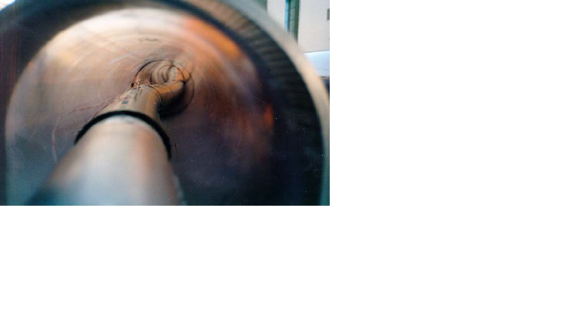

The system to be analyzed comprises a long slender cable (typically about 100 mm diameter and 50-100 m length, but longer spans are possible) initially installed straight on bottom of a circular empty duct. The cable is fixed at both ends, and the duct can be assumed rigid.
During operation cable temperature will increase and the cable will therefore be subjected to expansion forces, causing it to move within the duct. By experience the cable loose its straight configuration tending towards a helix as heating and expansion increase. This type of behavior is named “snaking” (see attached image).
