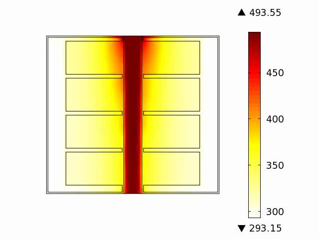

Lechoslaw Krolikowski
Posted: 1 decade ago 2011/11/09 12:40 GMT-5
I've run your simulation. It looks fine. See attached files. Animation shows how heat penetrates from water to aluminium and SS. Plot of average outflow temperature vs time shows that water loses heat.
Andrzej
Hi, I've run your simulation. It looks fine. See attached files. Animation shows how heat penetrates from water to aluminium and SS. Plot of average outflow temperature vs time shows that water loses heat. Regards, Andrzej

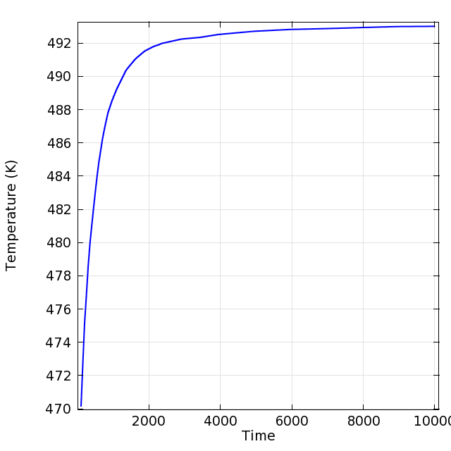

I dont understand.Looking at the plot Av-Out vs T,i see that the temperature of the fluid increases until 493K,so its not loosing heat,and in the other plot the entire pipe its at the same color.The fluid temperature at the end should be inferior than 493K,isnt it?
Could you explain me?

AND HOW DID YOU DO THE OUTvsT PLOT??Thanks
Hi Andrzej, That you for looking my model. I dont understand.Looking at the plot Av-Out vs T,i see that the temperature of the fluid increases until 493K,so its not loosing heat,and in the other plot the entire pipe its at the same color.The fluid temperature at the end should be inferior than 493K,isnt it? Could you explain me? Thanks, Best regards, Carlos AND HOW DID YOU DO THE OUTvsT PLOT??Thanks
Posted: 1 decade ago 2011/11/09 16:14 GMT-5
In the limit, when time tends to infinity, the temperature tends to 493K (inflow temp.) in all domains and the rate of heat transfer goes to 0. Under these conditions (steady state) the outflow temp. is equal to the inflow temp.
How to get the plot of average outflow temp. vs time?
Under the Results node right-click Derived Values. Choose Average > Line Average. Line Average window appears. Under Selection choose boundary 28. Click = icon (evaluate icon). In the Results window (right-bottom corner) click Plot icon.
Andrzej
Hi, In the limit, when time tends to infinity, the temperature tends to 493K (inflow temp.) in all domains and the rate of heat transfer goes to 0. Under these conditions (steady state) the outflow temp. is equal to the inflow temp. How to get the plot of average outflow temp. vs time? Under the Results node right-click Derived Values. Choose Average > Line Average. Line Average window appears. Under Selection choose boundary 28. Click = icon (evaluate icon). In the Results window (right-bottom corner) click Plot icon. Regards, Andrzej
Posted: 1 decade ago 2011/11/10 11:09 GMT-5
Why do the domains tend to 493K if the intial value is 493K??
CAN I DO A PLOT "OUTFLOW TEMPERATURE vs TIME" or it doesnt have sense?
Initial temperature of Al+SS domains is 293K as you can see in Prueba Conjugate HT.mph.
Hot water of the constant temperature 493K flows into your system. All outer boundaries (exept inlet and outlet) are insulated. Therefore, the final temperature of all domains (H2O+Al+SS) must be 493K irrespective of the initial temperature.
Outflow temperature Tout is a function of the two variables: t (time) and x-coordinate. You can plot Tout vs t fixing x or
Tout vs x fixing t.
Andrzej
