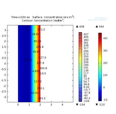

Negative Concentration in Domain
I've been trying to simulate the transfer of ions in a nano-channel using a Nernst-Placnk-Poisson-Boltzmann system, and I'm getting Negative Concentrations in the domain. Can someone help me with identifying possible mistakes in my model ?

The problem of negative concentrations has appeared on this forum repeatedly, and there is no easy way out. I have faced the same problem with convective diffusion. I almost got rid of it with better meshing in the channels. I used swept mesh across the channel with at least 10 elements and geometric distribution so that at the channel boundary the mesh was at densest. Convective diffusion is a notorious problem.

What are your solver settings? Do you use a fully coupled solver ? You can use a segregated solver and use the "lower limit" option and force the lower limit to be zero.
If you problem is very stiff, you will have some convergence issues when you do this. You will have to mesh the "negative concentration region" very densely. Also I would suggest that you ramp up any source terms in your problem.

You will also find this knowledgebase article addresses this question.:
www.comsol.com/support/knowledgebase/952/

Thank you all for your comments ! I found that having a finer mesh size helped with the issue.
