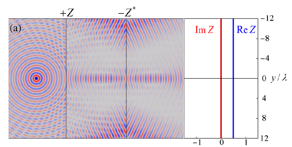

Posted: 1 decade ago 2015/03/09 6:37 GMT-4
Thanks for your reply. Its an RF problem. I have attached an image below how I want it to be.

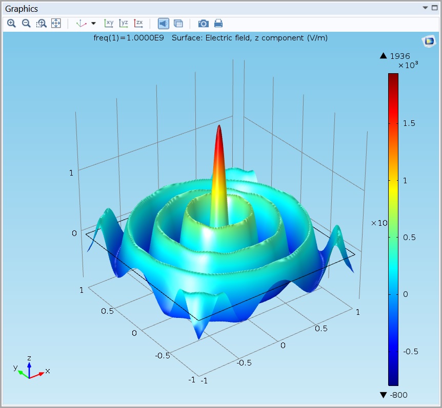

Posted: 1 decade ago 2015/03/10 19:00 GMT-4
I've attached an example.
Posted: 10 years ago 2016/02/12 5:36 GMT-5
Hi Dear sir its very useful file. But once i simulated then its field is inverted as compared to yours plot. Then i needed to put -1A to get same like plot of yours, whereas you put 1A. Where am i making mistake?
Thanks & Regards
Hi Dear sir its very useful file. But once i simulated then its field is inverted as compared to yours plot. Then i needed to put -1A to get same like plot of yours, whereas you put 1A. Where am i making mistake? Thanks & Regards
Posted: 10 years ago 2016/02/15 4:05 GMT-5
Hi Sir I found correction. You used study at 180 degree and by default its at 0 degree. Whats reason behind out of phase plotting the data?
Thanks & Regards
Hi Sir I found correction. You used study at 180 degree and by default its at 0 degree. Whats reason behind out of phase plotting the data? Thanks & Regards
Posted: 10 years ago 2016/02/15 4:06 GMT-5
Hi Sir Robert,
Thanks & Regards
Hi Sir Robert, I found correction. You used study at 180 degree and by default its at 0 degree. Whats reason behind out of phase plotting the data? Thanks & Regards
Posted: 10 years ago 2016/02/15 17:43 GMT-5
I plotted it that way because the resulting plot was prettier. The plot is just a snapshot at a particular phase. Feel free to pick and plot any other phase snapshot of the solution that you prefer.

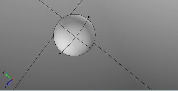

Posted: 10 years ago 2016/03/13 11:45 GMT-4
Dear Sir,
I hope every thing is fine with you.
I want to add 2 electric field sources around sphere. I used 2 electric point dipole in 3D around it on the same axis(z).
1- I determine 2 physical points and then linking between them and dipoles.
2- After that I choose the dipole moment option and I get 3 data entries for x, y and z, I know that these values determine the polarization of dipole moment and according to these values the power will be perpendicular to the polarization direction.
My first question is how can I determine the polarization direction and the physical points play a role in that.
The second: how could I convert from [A.m] unit to electron volt.
The attached pic is my structure and it is radio frequency model
Thanks in advance
Dear Sir, I hope every thing is fine with you. I want to add 2 electric field sources around sphere. I used 2 electric point dipole in 3D around it on the same axis(z). 1- I determine 2 physical points and then linking between them and dipoles. 2- After that I choose the dipole moment option and I get 3 data entries for x, y and z, I know that these values determine the polarization of dipole moment and according to these values the power will be perpendicular to the polarization direction. My first question is how can I determine the polarization direction and the physical points play a role in that. The second: how could I convert from [A.m] unit to electron volt. The attached pic is my structure and it is radio frequency model Thanks in advance
