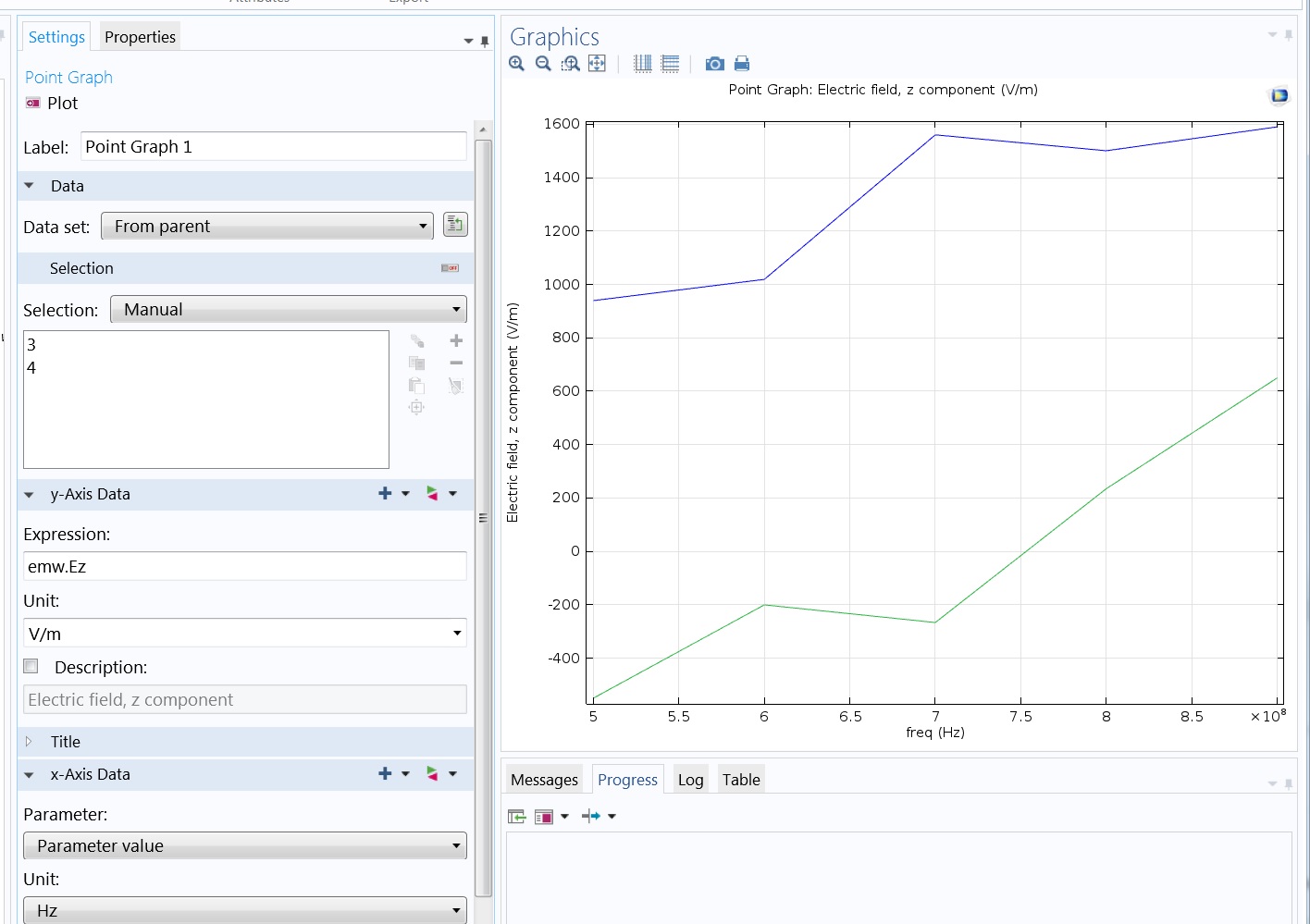

If you have more than one geometric point in your problem, you can load more than one point. Just select the second point the same way you selected the first one. I've attached a piece of a screen-shot that may make this clearer.

Thx, Robert, I agree if they are geometric points, we can load two or more than two of them. But if the points are from Cut Point 2D, it seems loading two or more than two points are not feasible. what I do now is export the data and plot them with matlab.

Then you add more point graph nodes under the same 1D plot group. Select one Cut Point 2D data set in each of them.
