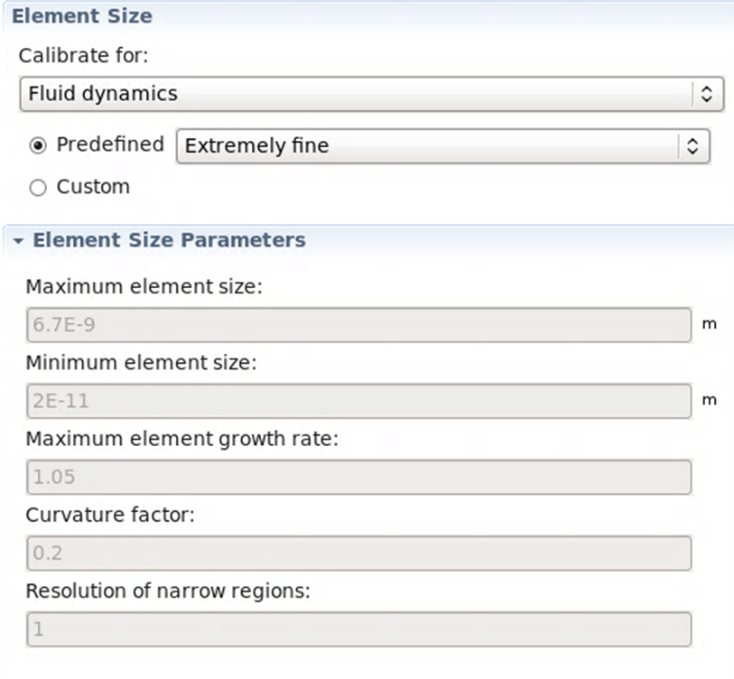

My simulation geometry is just 2D 1 micrometer by 1 micrometer rectangular box. I use comsol predifined :Extremely fine size shown in the attachment.
I just wonder whether the unsymmetric oppsite boundaries(one with +1V the other with -1V applied) is possible for zero flux since I see many models in gallery are zero flux for symmetric boundaries.

I am not able to reply to your latter question, I do not know. Your mesh probably is very dense, but if your domain is that small, the minimum element size should perhaps further decreased in order to have better resolution at the boundaries.

I have adoptted your suggestion of decreasing the minimal and maximal mesh sizes. I will report when I get the new resolution.

I have refined the mesh on the boundary, the flux do become smaller, but not within the error of comsol, I guess for my unsymmetric bc case, the flux might not be zero simultaneously...
