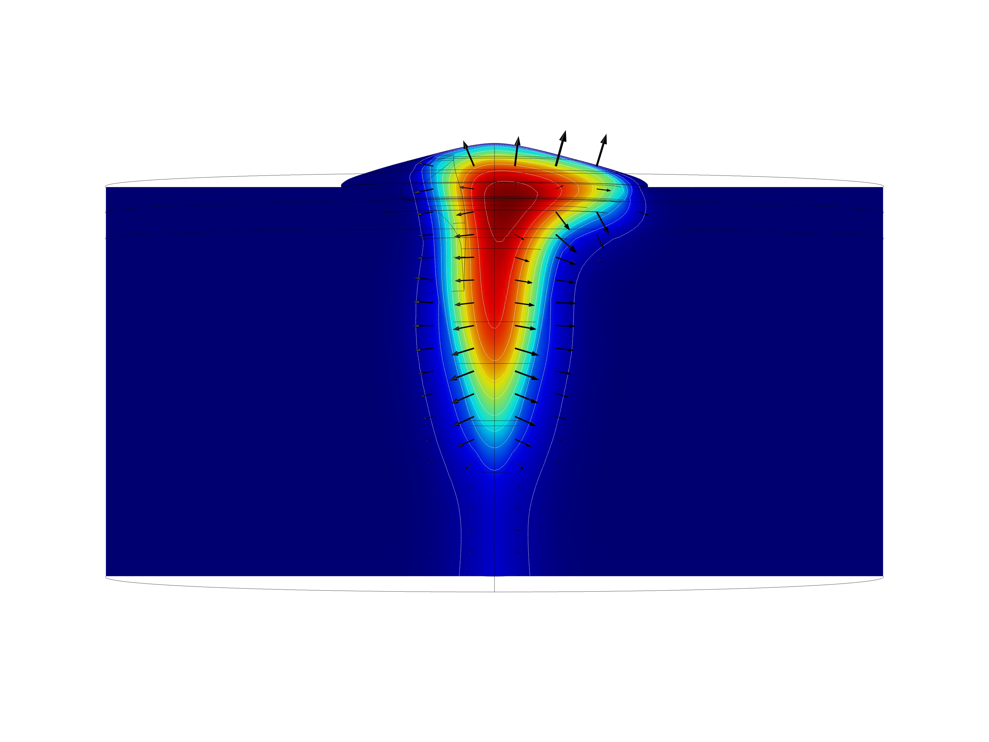

I have question about visualization of body contour in cross section in 3D model. I have cylindrical model of lava intrusion inside some sedimentary layers. I have generated slice with contour (isotherms) and I would like to see borders between particular parts of model (sedimentary layers, intrusion). The problem is distortion of borders, because on the 2D slice, the borders are still 3D (see attached plot).

I'm not sure I understand you correctly, nor the image, but a few tips:
1) I often use single colour contour plots of type white or red to better see the contour shapes, and turn off the legend
2) the deformations, in V4 are set per image, so you enable it or disable/delete it plot by plot (rightclick), but you must apply it on both surface, slice and contours if you overlap all (anyhow surface + contour mostly meeses up, I use only one of th two at one time
3) I'm sure the wire plot of the model (undeformed) is set somewhere, but just now I cannot tell where
Have fun Comsoling
Hi I'm not sure I understand you correctly, nor the image, but a few tips: 1) I often use single colour contour plots of type white or red to better see the contour shapes, and turn off the legend 2) the deformations, in V4 are set per image, so you enable it or disable/delete it plot by plot (rightclick), but you must apply it on both surface, slice and contours if you overlap all (anyhow surface + contour mostly meeses up, I use only one of th two at one time 3) I'm sure the wire plot of the model (undeformed) is set somewhere, but just now I cannot tell where Have fun Comsoling Ivar

To change the default view settings, go to 'View' node displayed under 'Results', and set as per your requirements.
To view wireframe select the plot Volume/Surface and in the Settings window go to Coloring and Style then select Wireframe check box.
Hope this will help you
AndyT
Hi, To change the default view settings, go to 'View' node displayed under 'Results', and set as per your requirements. To view wireframe select the plot Volume/Surface and in the Settings window go to Coloring and Style then select Wireframe check box. Hope this will help you AndyT
