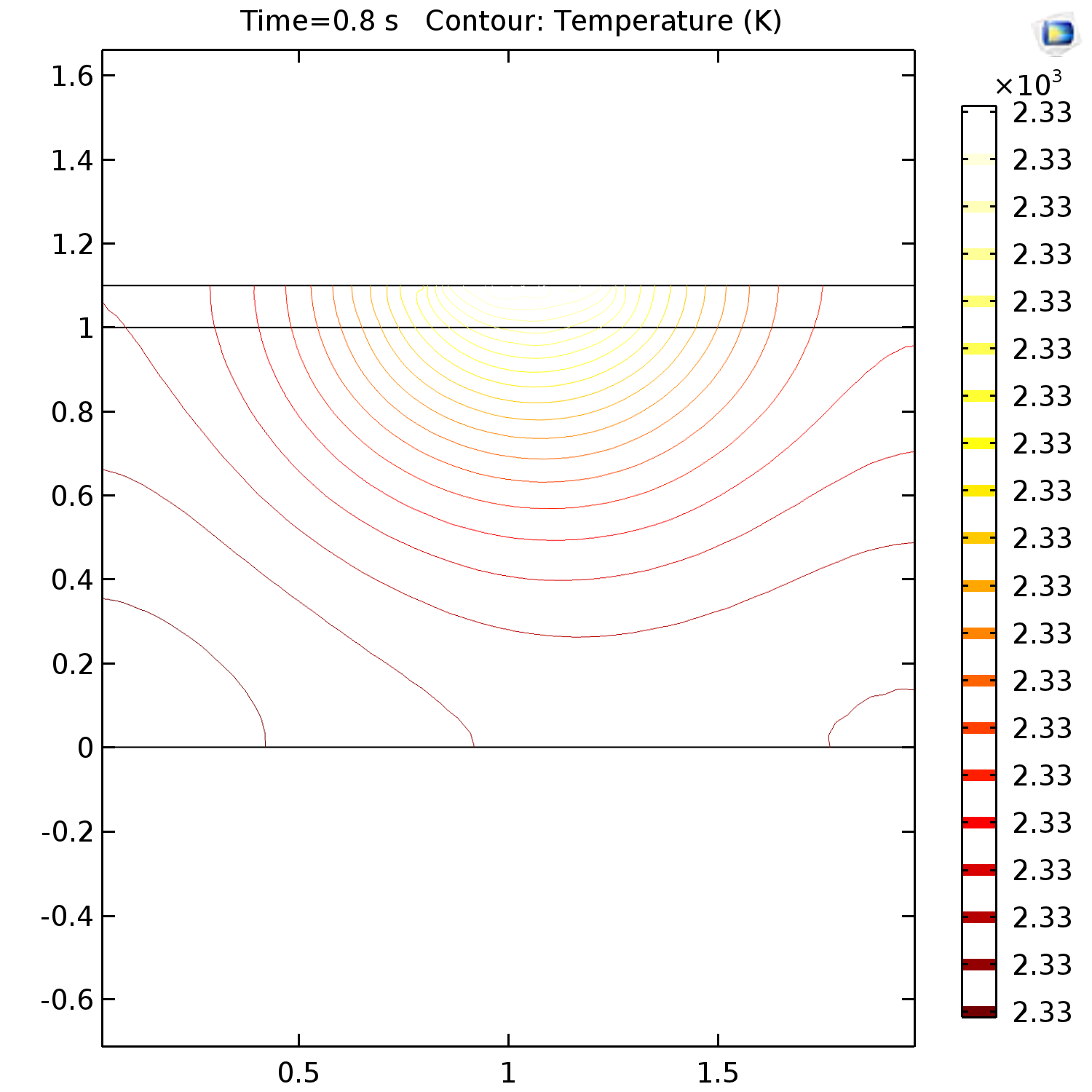

I would like to thanks Ivar and comsol team for their support, as new I am struggling to the modelling of a laser heating a layered materials with the second layer transparent to the laser wavelength.
How can obtain a general temperature profile which take the difference in materials properties:
By solving 2 diff equations ? or just one equations with a weak boundary condition at the interface for heat flux and temp continuity.
I do not know how to integrate the interface boundary in my one equation,
please an Hint
Merci beaucoup.
