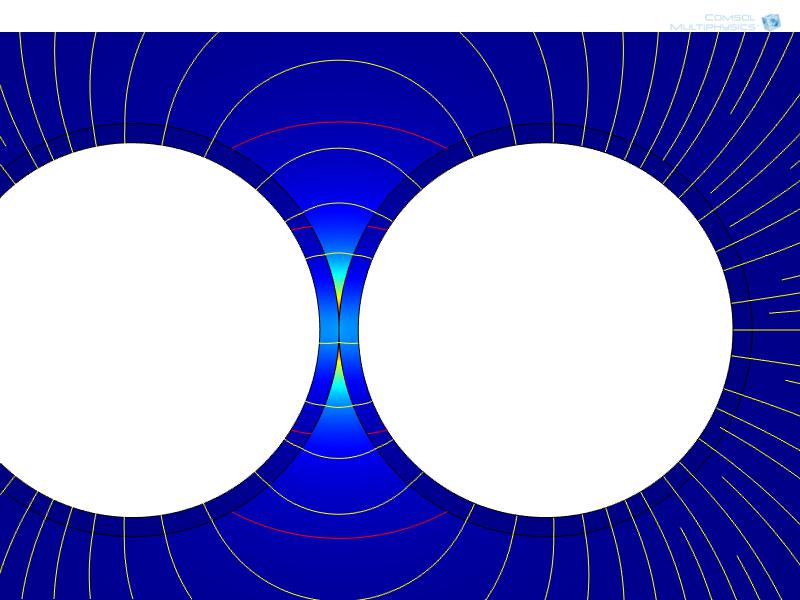

I am trying to get my own paschen´s law diagram of to electrodes with an overcoat. and I need to measure the length of the electric field lines. I already define an integral with the particle tracing feature and i was succesfull to get the whole lenght of the line. My question refers in how can i get the lenght of the line just in one orea or domain. cause i want to avoid the length of the line inside the the overcoating area.
