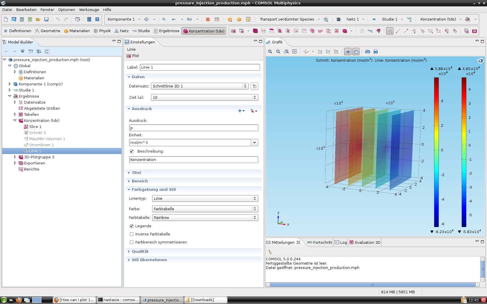

you can find under "results" > "dataset" > "cut line 1D" the defined cut line which dataset is choosen to "3D cut line". After I added this line under "results" > "concentration" (line 1), the cut line is shown but the profile along this cut line ( concentration along one axis) is not demonstrated. How can I draw the concentration course along this cut line?
Thanks and cheers
Nastasja K.
Attached you can find a screenshot what I see.
