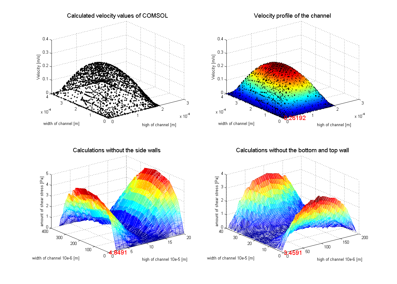

If you have a 3D model you can extract one velocity slice and do further calculations in matlab. I calculated the shear stress along the X and Y axis, one result is attached. Of course, this result is partly wrong because only the effect of 2 of the 4 walls is noted. But I think that the calculations are good directly at the middle of the involved walls, because there is less effect of the other walls. As further as you go to the edges or in the middle of the channel, the effect of the not noted walls increases and the results get huge error. But this could be a way to get your maximum shear stress values with a small error because the maximum values should be located in the middle of each wall.
The minimum value I am not quite sure about, but assuming laminar flow (micro fluidic) there should be no stress in the middle of the channel, but I will double check that.
I still look for a way to visualize the overall shear stress profile in comsol, or a way how I can combine the results I created in matlab. I am thankful for any help.
T. Gumbel

I just implemented it in comsol with the result I added (first two pics).
The velocity profile looks fine. The shear stress not really. The stress values at the bottom and top wall are acceptable but the stress on the sidewalls is wrong I think.
So if I sum up all components
eta0*abs(vy) +eta0*abs(uy) +eta0*abs(wy) …
+ eta0*abs(vx) +eta0*abs(ux) +eta0*abs(wx) …
+ eta0*abs(vz) +eta0*abs(uz) +eta0*abs(wz)
the third profile is calculated, but I am not sure whether summing up all individual results is allowed?
Do you have any advice?
